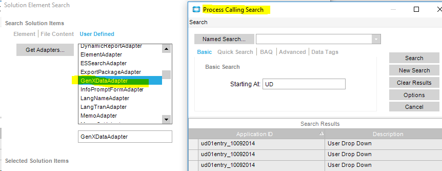

How do I add a Process Call modification for MES to a solution file? What type of object is it?

I was looking for process calls like to link default MES buttons to other screens. This only gave me context menus.

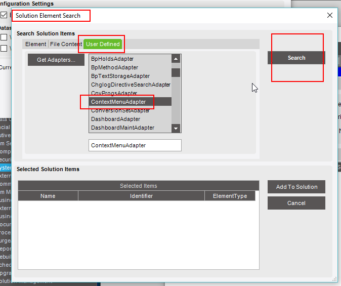

Did you have a problem using ContextMenuAdapter, by clicking Add to Solution it never gets added to the Solution?
Looking for a way to Export a Custom Context Menu or even any Context Menu. cc @Chris_Conn @josecgomez
Yes! Just tried it in 10.1.600 - no workey. Other user defined items (like GenXData) do work though. Booooo!

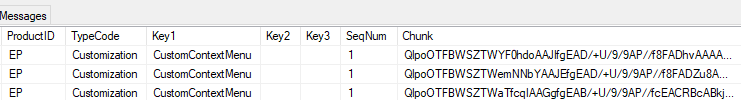

Dang it! Need a way to export it =) I also did a Global Search through SQL, couldnt find my description anywhere - could be tucked away in a base64 encoded type string. Time to ping the master @Bart_Elia to ask of another way to export or the table name so I can do a SQL Script for “Context Menu”
Chunked indeed -
FormFunctions.SaveXmlDocument(base.sender, xDoc, “CustomContextMenu”, str, allUsers, out filePath);
FormFunctions.ChunkNSaveStringByID(base.sender, this.company, this.product, typeCode, “CustomContextMenu”, userId, string.Empty, “Custom Context Menu”, newBuildVersion, false, xDoc.InnerXml);
Ice.XXXChunk?
Looks like it and its bundled in with other fields from Quick Search as well…
Now the question is how can I export this properly =), might have to just re-create it in all Company’s
