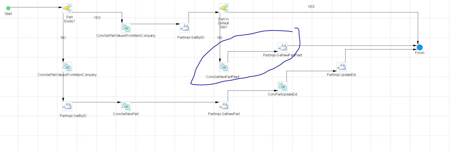

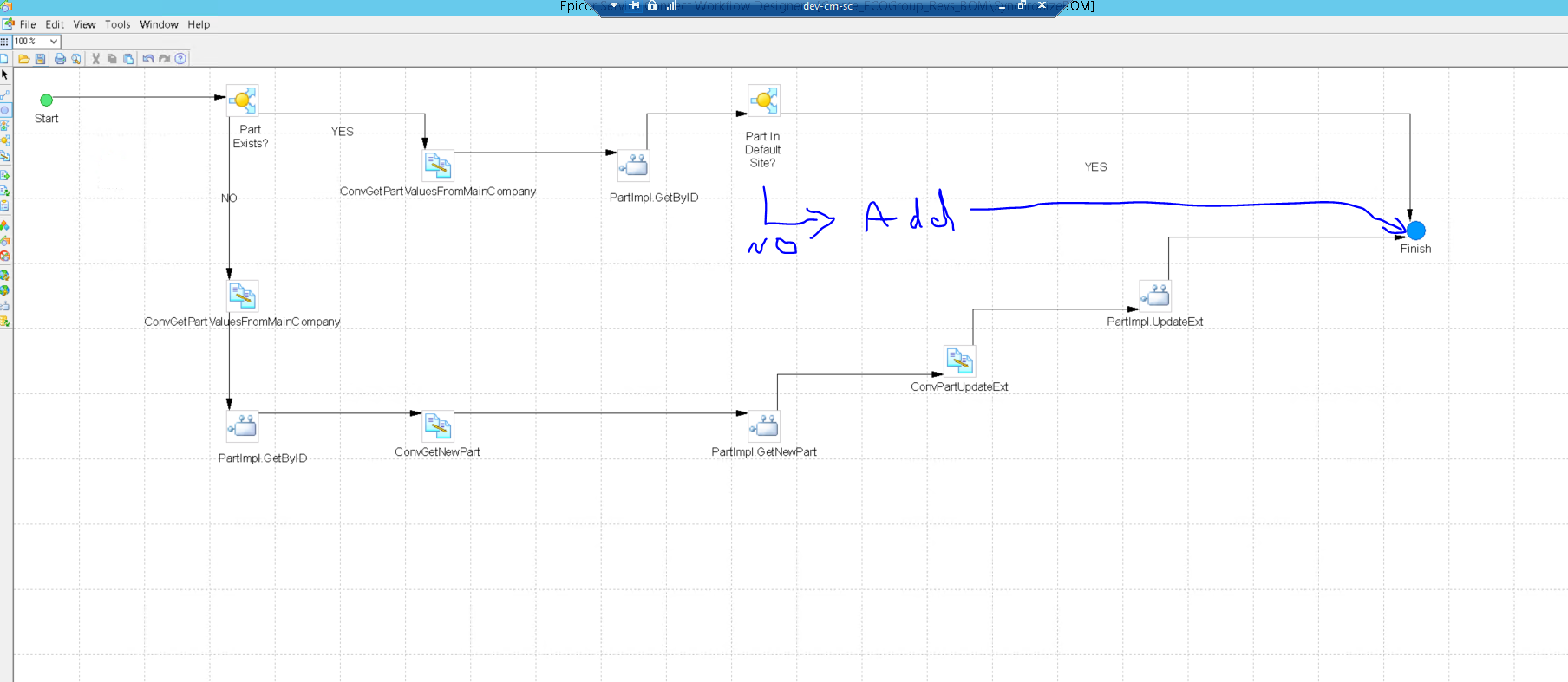

I have a workflow in Service Connect that looks like this:
I can’t seem to find a method in the Part BO to be able to add a site to an existing part.
