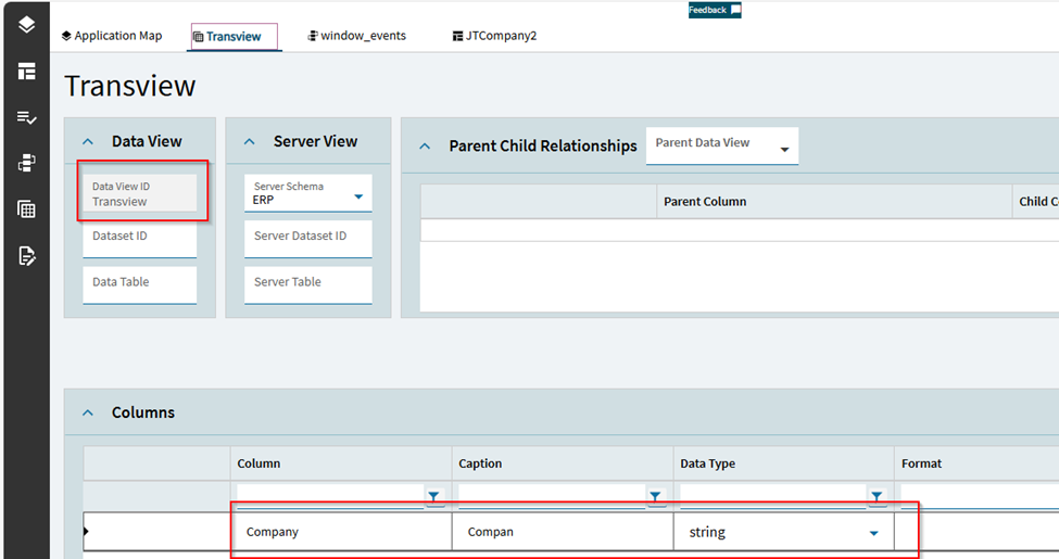

Add the Transview dataview:

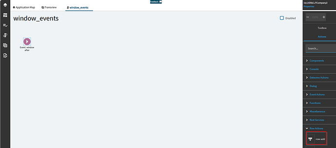

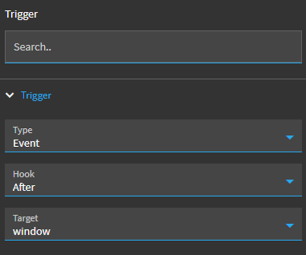

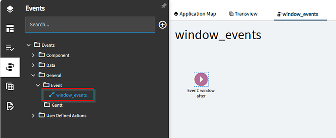

Look for event “window_events”:
If you don’t find this event already in the app, create a new event with this trigger.

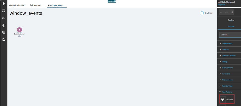

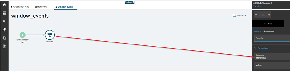

Add a “row-add” component from the toolbox:

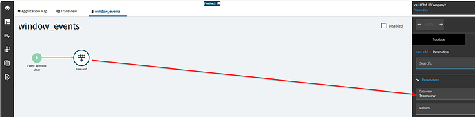

Set the dataview in Parameters:
(Leave the Values field empty.)

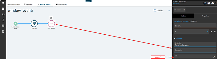

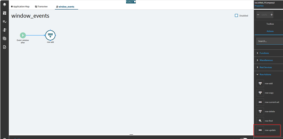

Add a “row-update” component:
In Parameters, add a parameter and select colums. . . and add a column.
Add the binding, and in the Value JSON editor enter “”.
That should have the Transview populated with a single row and the Transview.Company field initialized with an empty string.
