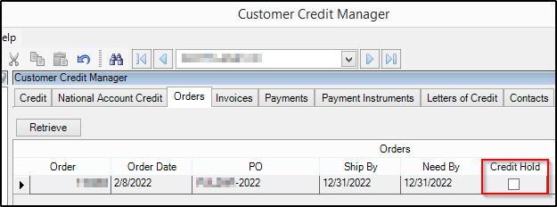

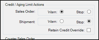

Or you could use customer credit manger and set credit limits on all the prepaid customers to.01. Then you can use the system to stop shipment for all orders on credit hold (Or not paid).

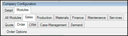

In Company Configuration Under Modules/Sales/Order
Set the Shipment to Stop
Then use the Customer Credit Manager module to release individual orders as needed.
