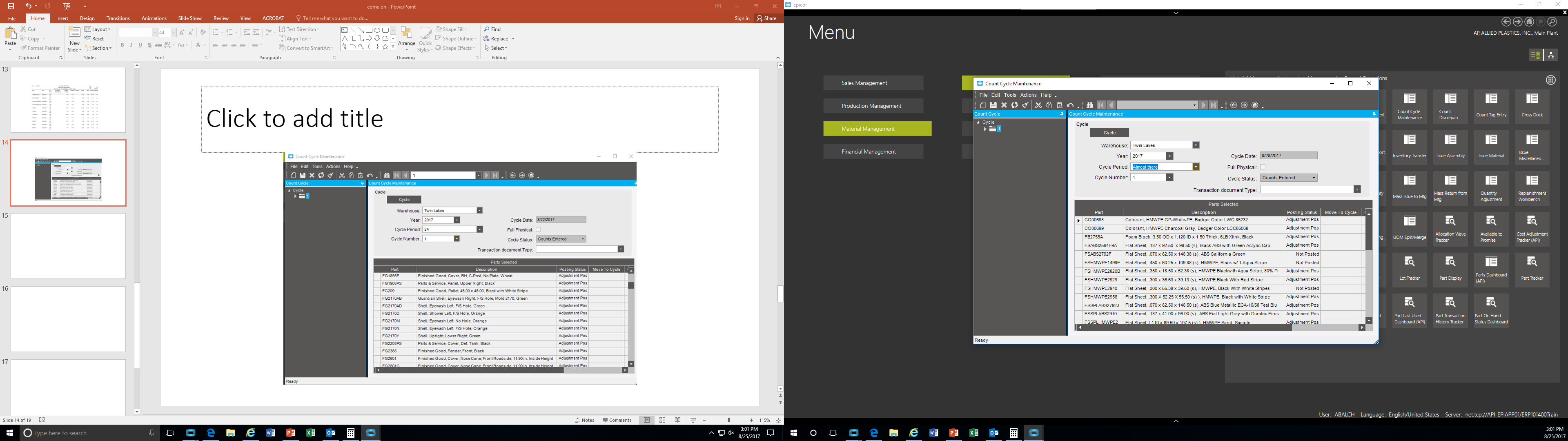

I have finished my cycle count and posted my counts in the action option in cycle count maintenance. I realize that some of the parts are Adjustment posted and some are not. I was wondering if anyone could tell me why some of the parts are not being posted?
Hi Ashanti,
Do you possibly have a screen shot? Are you getting a specific error?
Its on the right screen
