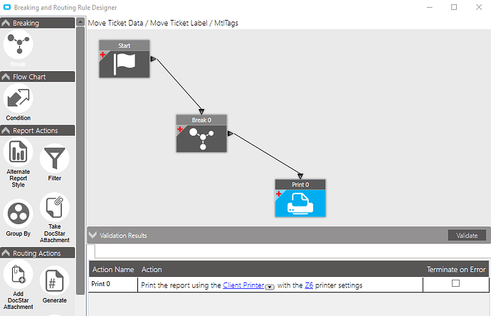

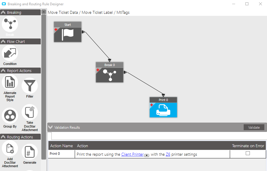

It sounds like the routing may not be set up correctly. Can you post a screenshot of the flow?
Here you go.
They must be saying “No” to running the routing as what you have should work. I have instructed all our employees on what a routing is and what to do when they see one. Beyond communication, I do not know of any way to force the routing to run every time. You might be able to use a Data Directive, but I am not sure.

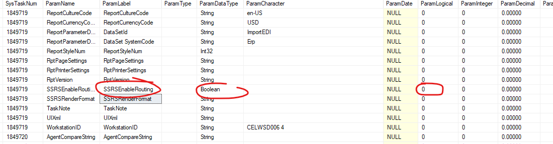

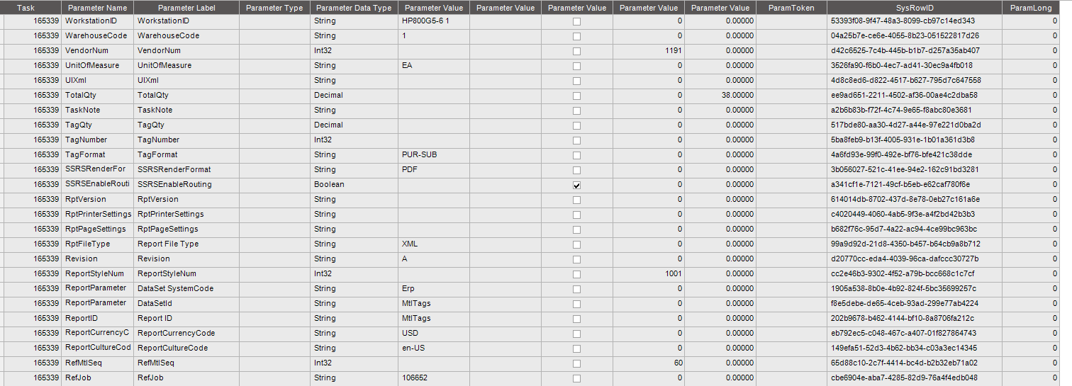

Here are the values, not sure what they mean

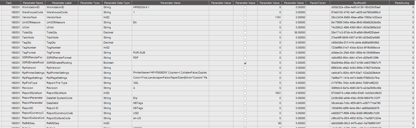

Here are the values when print preview is clicked and it sends it to the right printer.
I was looking for the SSRSEnableRouting, just making sure it was flagged to use routing after you selected “do not show again.”
