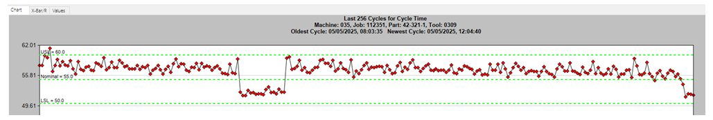

Is there a report after parts run in Advanced MES (Mattec) that shows actual cycle times for each cycle? We can see it while the job is running but would like to go back to see it after it runs.

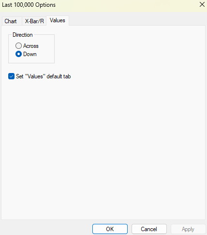

From the Realtime display (your current screen) and at the bottom of the window, choose Option, and select the Values tab. Pick the time frame or number of cycles:

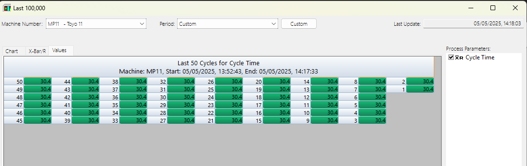

Now the value screen will show the Cycles.
If you want to see the raw data, in the database, connect the JobQueue table with the ParmDat table. All the information is there.
I do not see an option to select. Just making sure I am explaining what we want to see. It wouldn’t be on a part that is currently running. we want to be able to look at old jobs. Quality wants to be able to see how it ran during the cycle time to see if there was an issue with that (if there was a customer complaint)
