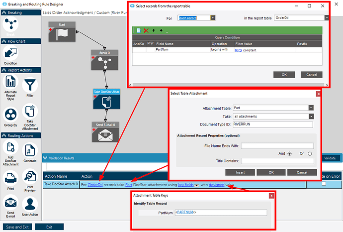

I am trying to add a docStar attachment, not take a docStar attachment.
Ah - sorry - I misread the initial post. I do have an example of that working in our environment as well.
Have you checked the Document Type ID? It’s a freeform field on the attachment properties form but is a record key in Document Type Maintenance and a folder name in DocStar. A typo here might cause an object reference error.

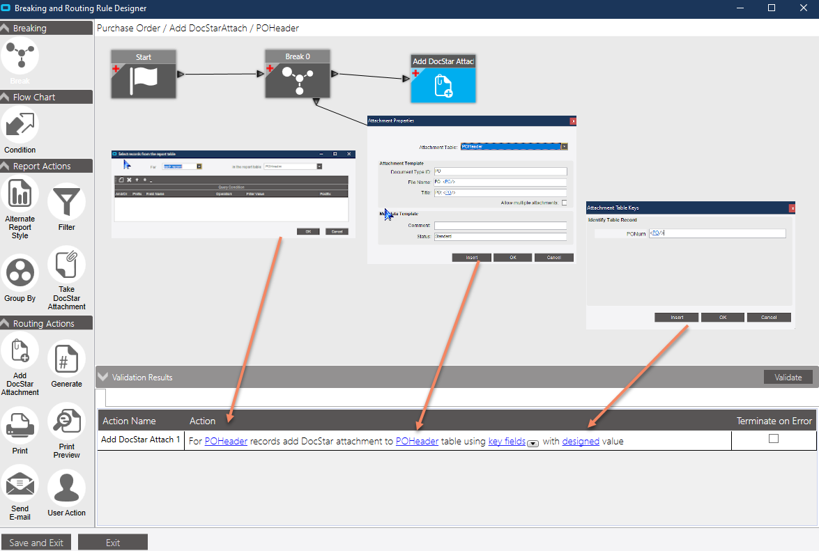

Can you post a screenshot of how the action is configured in APR, including each of the specified options?

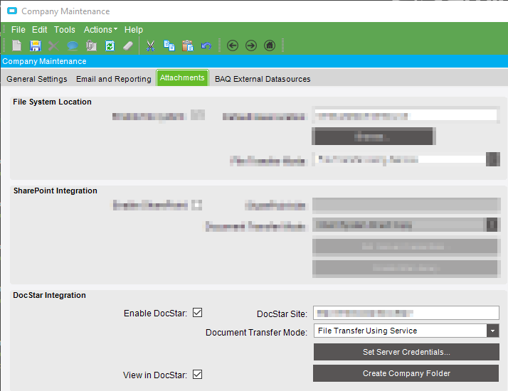

  1. Company Maintenance > Attachments
    DocStar should be enabled with the root site specified (e.g. http://servername/DocStar/). We transfer as a service and have stored the server credentials. Create the company folder if you haven’t already done so.

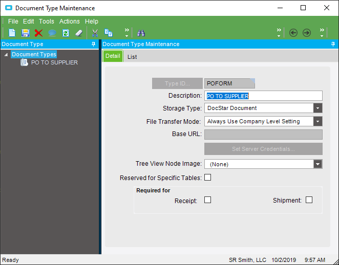

  2. Document Type Maintenance
    The document type should have a storage type of DocStar.

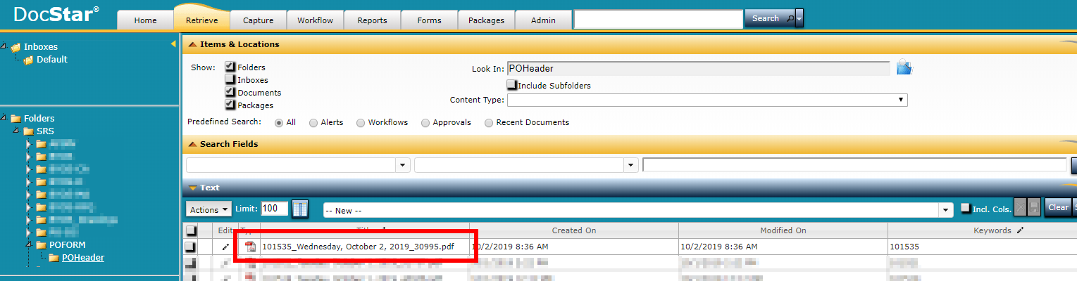

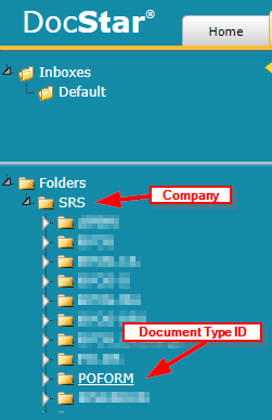

  3. DocStar
    DocStar’s folder structure should be set up at this point. Log in with the credentials used for the service in step 1 and confirm that you can see the folder structure with the Company ID and the Document Type ID.

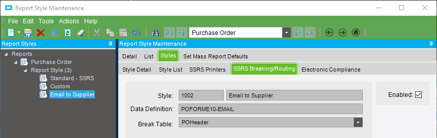

  4. Report Style
    Enable routing on the report style.

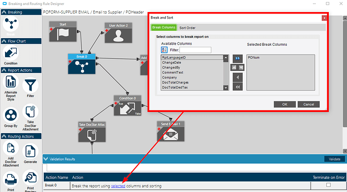

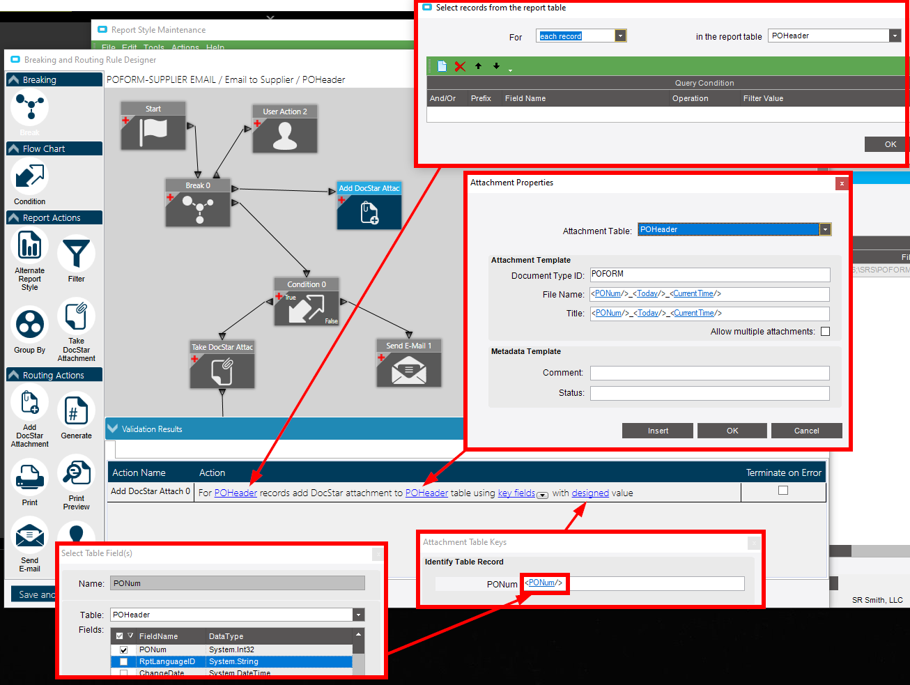

  5. Breaking & Routing Design > Break
    Break on the PONum column.
  6. Breaking & Routing Design > Add DocStar Attachment
    Add the DocStar attachment using the Document Type ID specified in step 2.

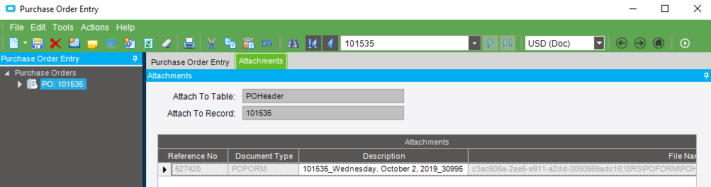

  7. Purchase Order Entry

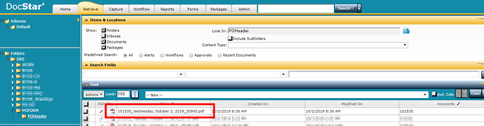

    After running a preview of the report with the specified report style, it should show up as an attachment on the PO and in DocStar.
Ok, now it worked. I think I could have possibly had the wrong username and password set up in company maintenance. Thanks
