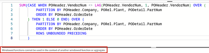

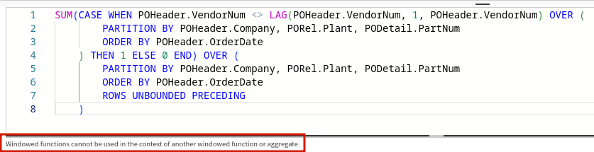

The BAQ designer is a powerful tool, but its parser is rigid; it often fails to validate calculated fields with complex clauses. This forces us to either write the query from scratch in a BPM or settle for less-efficient, multi-step BAQs.
The Proposed Solution: An Unofficial Hybrid Approach
I suggest a hybrid approach that combines the best of both worlds: the BAQ designer’s visual structure and the BPM’s ability to execute custom SQL.
  • Use a mostly valid BAQ with a Placeholder: In the BAQ designer, create the main query with all the necessary tables and joins. For the complex calculated field (e.g., Run_ID ), we would make a simple placeholder, like /* ApprovedPO */ null as Run_ID. The BAQ designer will validate this simple code without any errors.

  • Embed the Complex Logic in an Unused Subquery: The clever part is to create a separate subquery that is never joined to the main query . In this unreferenced subquery, we would add the complete, complex SQL code for our calculated field. The BAQ designer’s validation process doesn’t fully parse unlinked subqueries, which allows the advanced syntax to be saved without throwing an error.
    • Use corresponding field names.
    • Use the label to indicate the start marker of the table or placeholder.
-- This is the advanced SQL code you will put into the unused subquery.
-- It will be "injected" into the main query by the BPM at runtime.
       SUM(CASE WHEN POHeader.VendorNum <> LAG(POHeader.VendorNum, 1, POHeader.VendorNum) OVER (
        PARTITION BY POHeader.Company, PORel.Plant, PODetail.PartNum
        ORDER BY POHeader.OrderDate
    ) THEN 1 ELSE 0 END) OVER (
        ROWS UNBOUNDED PRECEDING
    ) AS Run_ID
  • Use a BPM to replace the Code: The final step is to create a Pre-Processing BPM on the BAQ. This BPM would perform a find-and-replace operation on the BAQ’s generated SQL string at runtime. It would find our simple placeholder (/* ApprovedPO */ null as Run_ID ) and replace it with the complex, unvalidated SQL from our dummy subquery. Finally, the BPM would execute this new, complete SQL string using the DynamicQuery object and then populate the BAQ’s result table with the data.

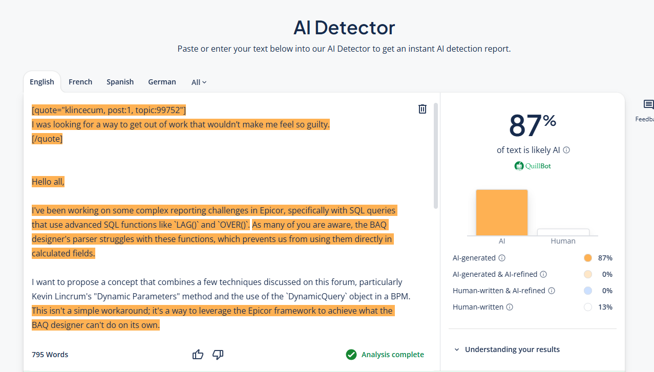

I use both of these in baqs all the time. Did chatgpt write this?
That’s not a BAQ error.
Implementing MITM SQL injection won’t solve this. It’s still not coherent SQL.
I’ll admit that my raw SQL skills are (very) rusty; I hadn’t done much with SQL for 10 years before getting back into Enterprise software. But I believe I used something very similar in the past. I can’t remember which dialect.
I know I didn’t always have to separate subqueries to perform this action.

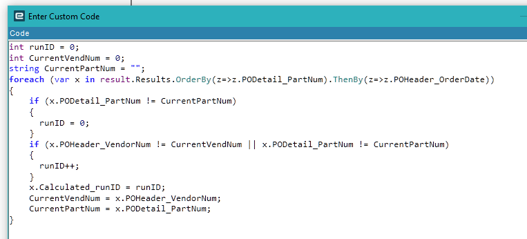

Sorry to pile on, but if it can’t be done in BAQ/SQL, then a preprocessing BPM on get list with an updateable BAQ gives you the ability to write C#, and if you can’t do whatever you need done with that level of code access…

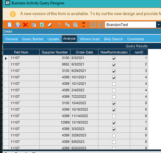

That is somewhat correct, I want to apply a sequence
That’s close, essentially, I want to apply a sequence to PO Vendors based on order date.
When the vendor changes, I want a new sequence ID so that I can group by that at a higher level.
One of the values I am looking to obtain is number of consecutive orders by the same vendor without relying on huge temp tables to obtain that number.
e.g., PO 1 2 3 4 5, for PN-1A to vendor 01 6,7 to vendor 02 8, 9, 10 to vendor 01.
So PO 1-5 would get Run_ID 1 6 & 7 would get Run_ID 2, and then 8-10 would get Run_ID 3.
    ) THEN 1 ELSE 0 END
This essentially marks the first row where the VendorNum changes.
The SUM() over () was intended essentially to create a new Run_ID each time the vendor changes.

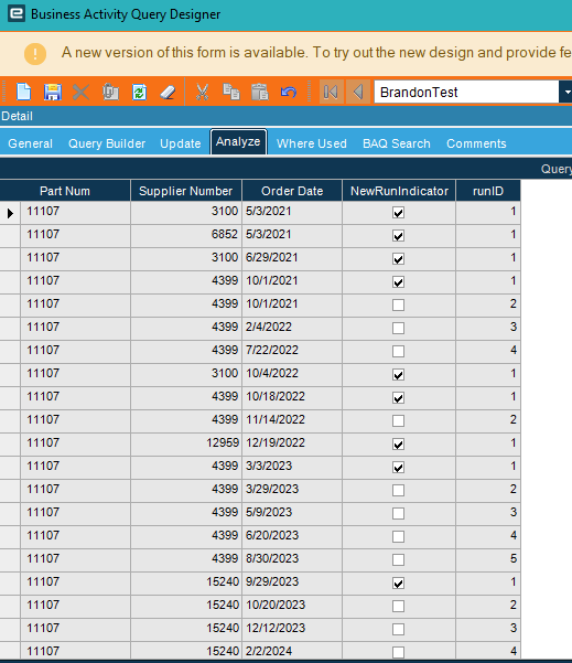

This essentially generates the Run_ID I’m looking for.
Joining back to this temp table is going to be intensive, though, I’ll have to play with it more.

I’m not at a computer right now to figure out the syntax, but why don’t you just use lag in your else to get the last value and add one?
Basically, if this row doesn’t match the last row, then one. If it does, add one to the last row. Lag will help you get both of those values.
edit. I read what you are looking for wrong, but this should still work.
If the last row vendor = this row vendor then last row run ID
else last row run ID +1
And you can use lag for all of that.
Edit (again) now I see what your issue is. You can’t refer to the same column when using lag, so you wouldn’t be able when to count up in the same column by using lag. Still poking at it.
I still think this can be done in SQL, but you probably need a CTE to do it, which is a pain, and I don’t want to take the time to figure out.

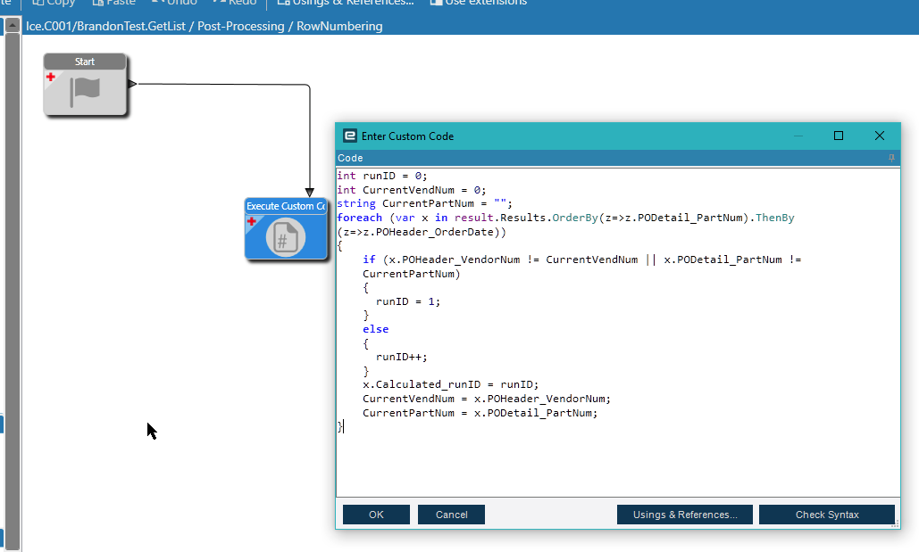

But, I did just do a quick BPM on get list post processing to loop through the rows and number the run IDs.
So, worst case, you can do it this way.

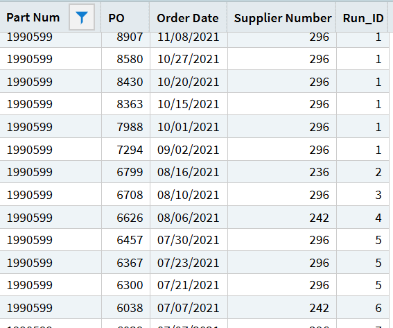

What makes po# 6799 a Run_ID of 2, for example? It’s unique in that set.
Everything’s unique in that set.
Crap, I realized again that I misread your logic. You want to increment the run ID every time the vendor changes. This is the logic for that.
It’s a different supplier number. 236 vs 296. (The logic is messing with my brain too)
On the same order date presumably in a hidden portion of the set? Supplier 296 gets 1 and 3 and 5, but why?
Just looking for a problem statement of how Run_ID is ordered and partitioned that isn’t phrased as a solution.
It’s the same run ID until a vendor changes. Once it changes, then it increments up. If it goes back it still increments up.
The following PO in the sequence of POs for PN 1990599 is from a separate vendor.
So, what you’re suggesting is that I use the UBAQ or a preprocessing BPM to update the incoming data to include a RUN_ID, and then continue to process it in SQL?
Or am I not completely following?
Nah, I was thinking that this was your end goal, and this was a way to get that. SQL can hand off to the BPM engine, but it can’t go back, so if you need this for more stuff, then my approach won’t work.
