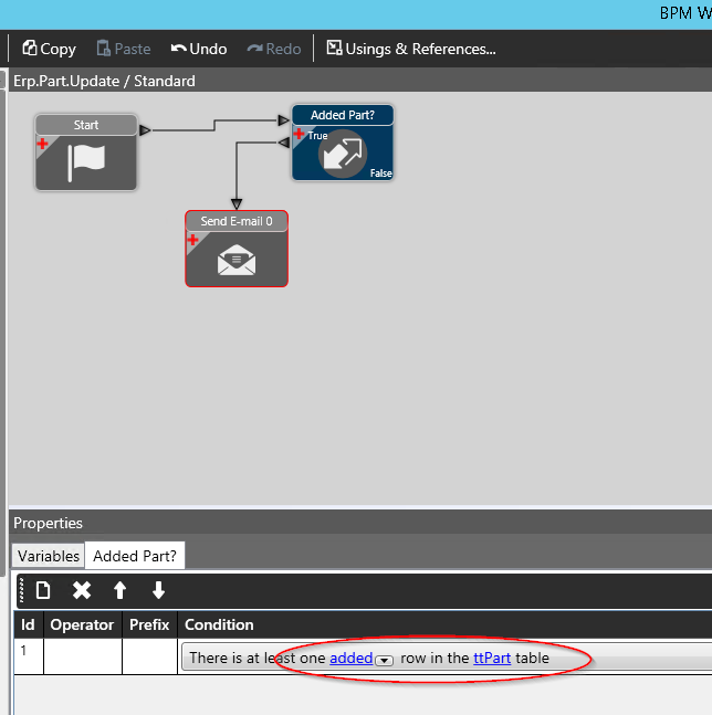

in a Standard Directive:
Look at the example from @timshuwy above. This is what all of ours look like for just alerting when something is added. There is a built-in condition for added records. Then just send email to whoever needs it.
