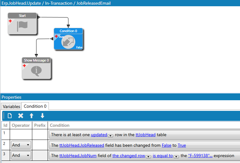

Our credit department has asked to have a BPM that alerts them when specific jobs are released. I’ve got a basic Data Directive triggering when I hard-code the job number, but I’d like to make it easier in the future for folks to self-serve. It’ll be changed to an email group instead of a message box.
My first thought was to enter the job numbers in UserCodes, but that’s still on IT to maintain. Would adding a DataTag ‘NotifyCredit’ on the job be an efficient solution? Seems like it’d be a slog to crawl through all the open jobs to see if it’s got a tag that requires notification, though…

If you remove condition #3 on you first condition. Could you Hang a second condition off the True side “Number of rows in the “query” is not less than 1”. linking job head >> job prod >> order rel>> orderdetail>>orderhed. Put table criteria on Order head for your specific credit hold code and credit hold.
