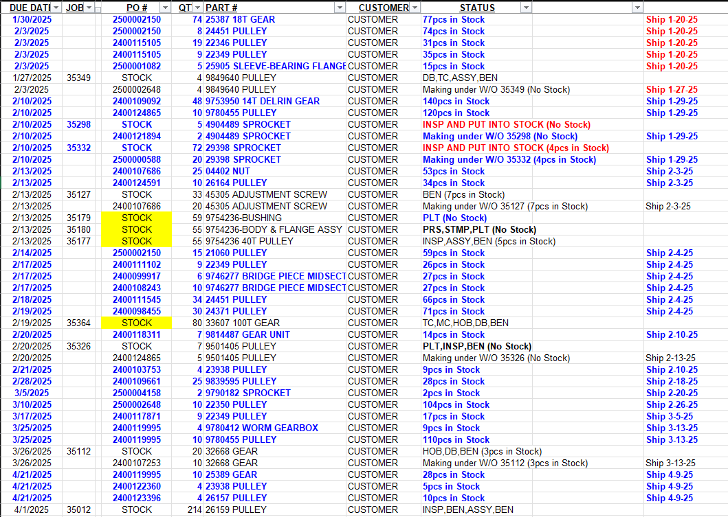

This is what I am trying to achieve. Our current Excel spreadsheet.

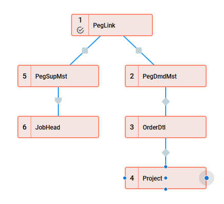

Ever try Multi-Level Pegging? It’s a process; you can run it as part of MRP or as its own process.
I’ve had to resort to it for similar reasons.

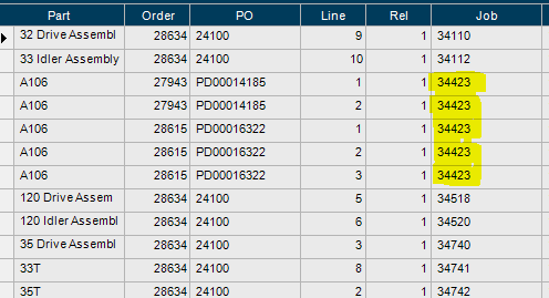

For me it runs at night (currently takes an hour for me) and then I have a BAQ based on the results. Four our business, it looks like so.
I’m being a little vague. If you want to know more I’ll ramble on…
I’m looking over the spreadsheet pic, and it looks all you need is a dump of the PartDtl table. (PartDtl is the Time Phase table; it stores all supply and demand.)
Then throw in the OH qty and such.
