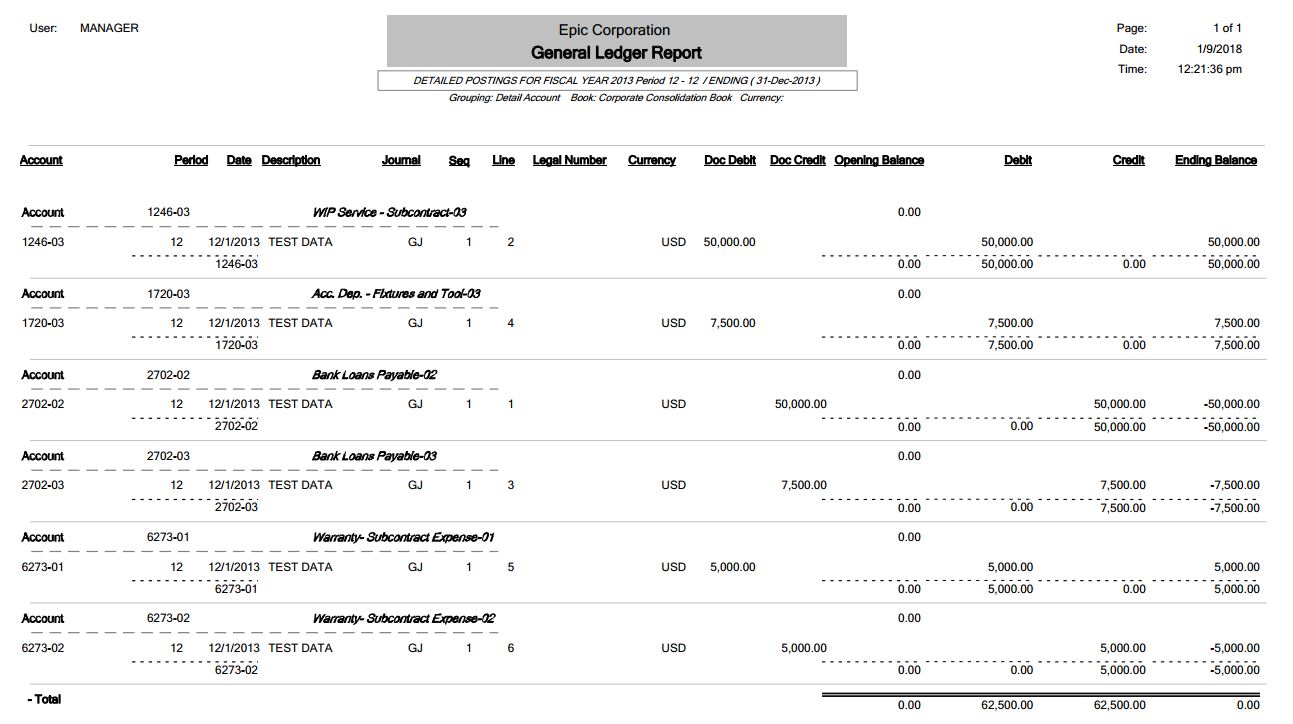

  1. ALLOC1.JPG = The database had no transactional data at all so I had to add some to it. This screenshot shows ALL of the accounts with balances in this database.

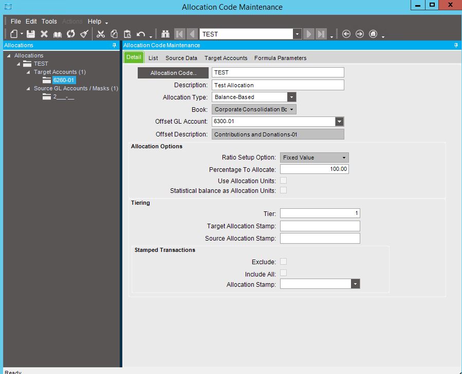

  2. ALLOC2.JPG = I created a balance-based allocation called TEST with an offset account of 6300-01. Note that this account does NOT appear in ALLOC1.JPG as it does not have a balance.
  3. ALLOC3.JPG = The source information is any accounts in the 2000 series (2____-__). Therefore the allocation (based on ALLOC01.JPG) should allocate out 57,500.00 (the sums of 2702-02 and 2702-03).

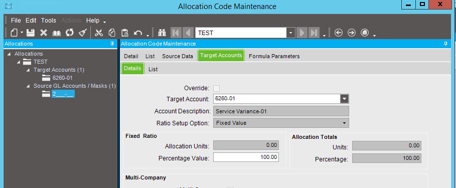

  4. ALLOC4.JPG = The target is set to 6260-01.

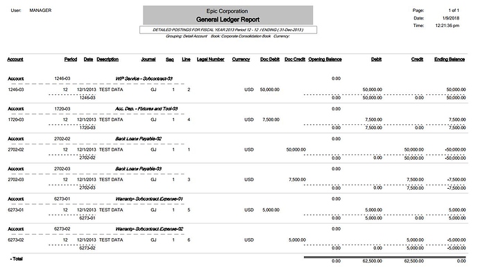

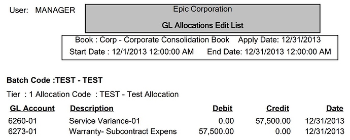

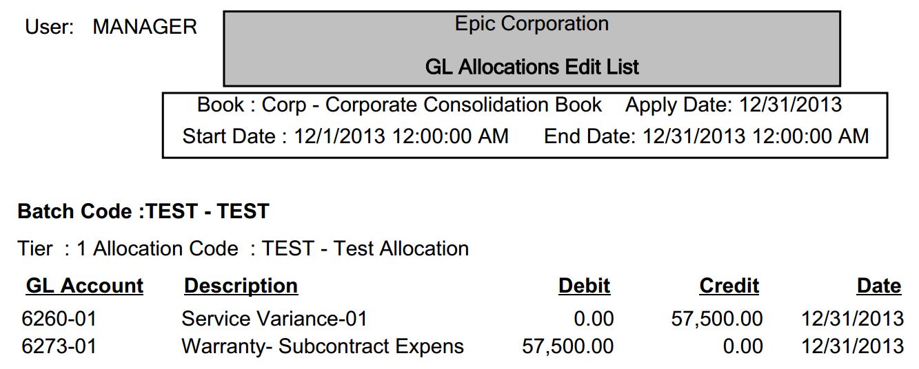

  6. ALLOC6.JPG = The allocation comes out perfect with the current offset account.

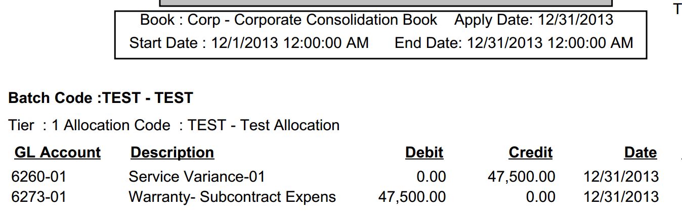

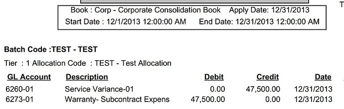

  7. ALLOC7.JPG = With the offset account changed to an account with a balance (6273-01) the allocation is now incorrect as it shows 47,500.00 instead of 57,500.00.

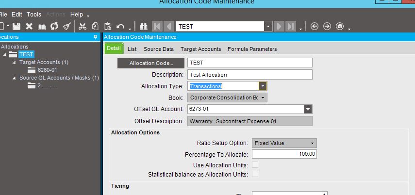

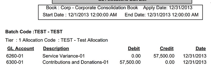

  8. ALLOC8.JPG = At this point I change the allocation type to Transactional. Note that the offset account is still 6273-01 which led to the incorrect balance based allocation amount.
  9. ALLOC9.JPG = The transactional allocation comes out with the correct amount of 57,000.00.
