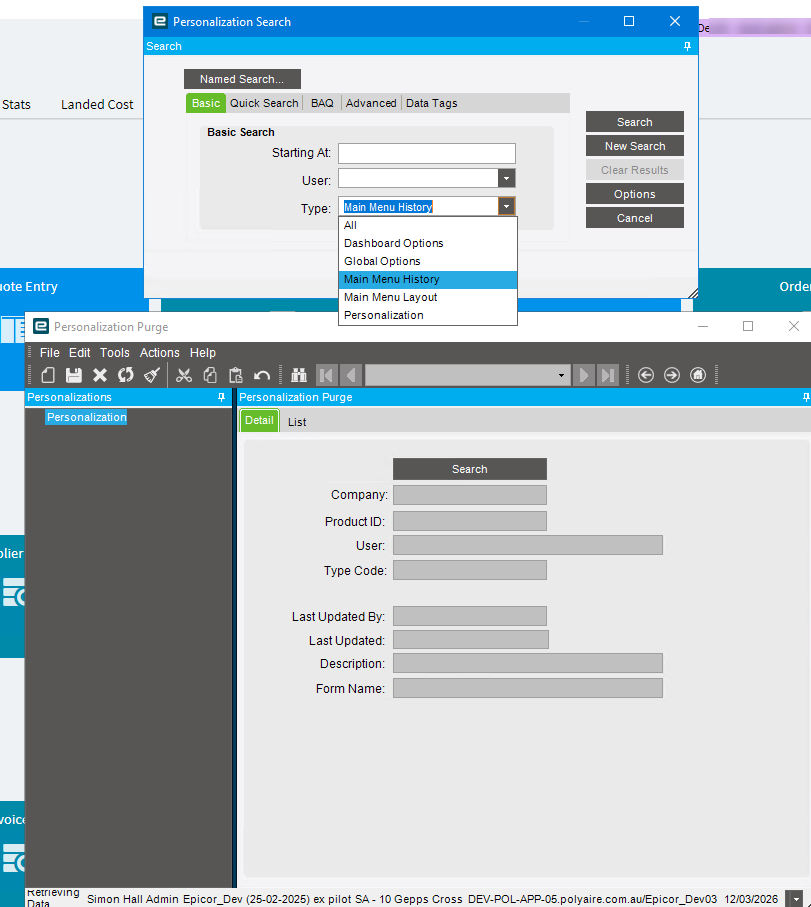

I could log into the kinetic UI via the browser with the same user account, I could even login to the classic on the same machine as a different user account. (Shift+right mouse on the shortcut, run as other user). In both situations it worked.
What ended up fixing the issue was to login as another user and use personalization purge and purge out the Main Menu history personalization for that account
I hope that helps someone in the future.
