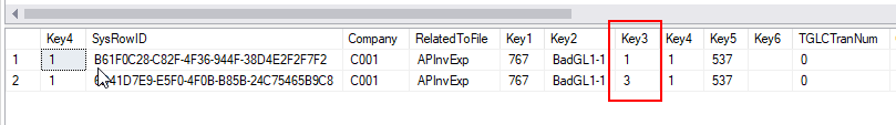

  11. Looking at the TranGLC records for that related invoice you will see that it created 2 transactions
  12. One pointing to Line 1 (Key3) and one pointing to Line 3 (Key3)
  13. However the invoice only has Line 1 and Line 2
  14. The issue appears to be because the original recurring invoice had a Line1 and a Line3 so the copying procedure that epicor uses for recurring is failing to see this and correct that in the new invoice.

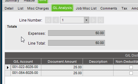

  1. Create an AP Recurring Invoice in any amount
  2. Add 1 line to the Invoice
  3. Add 2 different GL Line entries to the line above
  4. That is distribute the GL Debits across 2 or more GL Accounts
  5. Make sure the invoice is balanced run Edit List
  6. Post the Invoice
  7. Once the Invoice is successfully posted
  8. Run the next iteration of this recurring invoice
  9. If you go check Line 1 GL Tab on the new invoice you will notice that it is once again out of balance

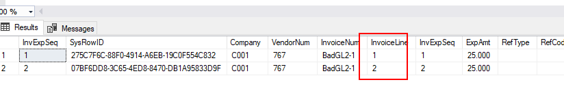

  10. This time the issue is in the ApInvExp table if you look at the records created there you will notice (2 or more) entries
  11. These entries reference Line1 as well as Line2
  12. If you recall our original invoice only had 1 line, the issue here appears to be that again the copy procedure to generate the next recurring invoice automatically increases the line number for each entry in the GL Analysis tab. So if you were to put in 10 GL Accounts on Line 1 ti would generate 10 lines worth of data inside the ApInvExp table which again causes the invoice to not balance.
