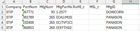

OK so i have another DMT issue this time loading Manufacturers Part details. When i did my last migration i used the Manufacturers Part DMT script using the below columns
This loaded the details fine

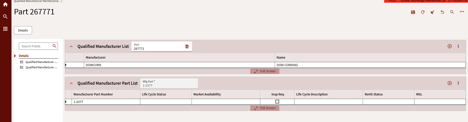

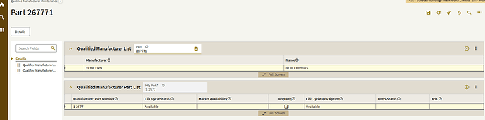

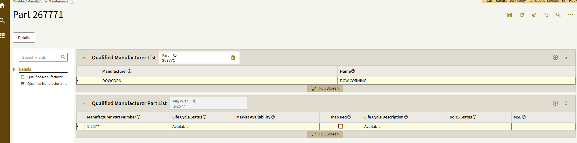

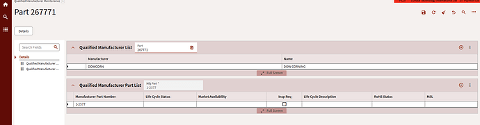

This is what i just loaded into my Pilot environment using Manufacturer Part DMT
And here it is in Qualified Manufacturer.
I have only used the Manufacturer Part DMT script to populate that data.

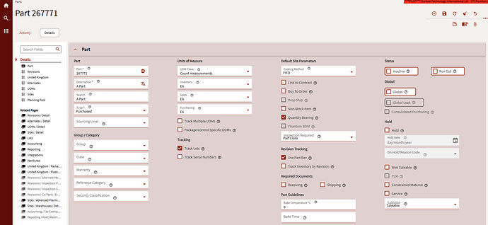

Did the manufacturer exist on the part before you loaded the DMT? Delete both the manufacturer part and approved manufacturer off the part and try again. I bet you will run into the MfgID not found error.
No, it was a new part i created in that environment
