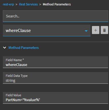

Is there any way on a Rest call whereclause to write it in such a way that it would escape (is that the right word?) those characters to allow them to go through? I suspect as built it’s stripping away that portion of the part number, which results in no PartTran records being found because it turns it into a part that doesn’t exist.
Example clause that I’d like to try updating:

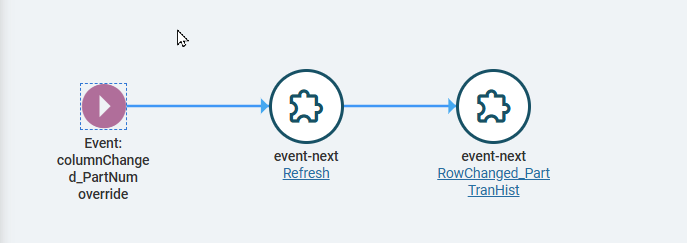

Its not the rest call that’s the issue. Its a single missing refresh call in 2025.1, they added it in 2025.2. Can fix with a simple override event in the layer in 2025.1.
This is the event you need to add:
Brilliant!
That fixed it. Do you know if it is the same exact event to make it work in Part Entry/Tracker activity tab?
