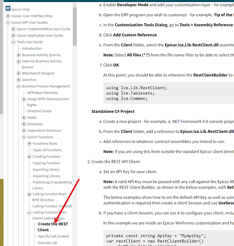

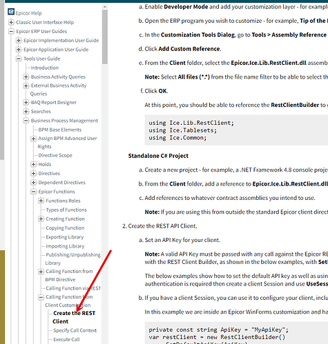

The help is gone in 2024.1 for calling it from classic.
Open ABC Code in Classic (2024.1)
Hit F1
or Search for
RestClientBuilder
It is LESS Than Intuitive but it does work

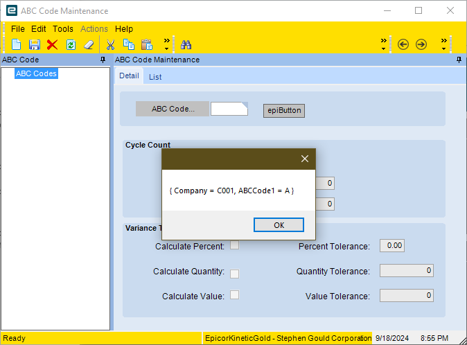

var restClient = new RestClientBuilder()
    .SetDefaultApiKey("YourAPIKeyHere")
    .UseSession(oTrans.CoreSession)
    .Build();
using(restClient) {
    var queryparams = new System.Collections.Generic.Dictionary < string,
        object > ();
    queryparams.Add("$top", 10);
    var abcGetResponse = restClient.Service.Get("Erp.BO.ABCCodeSvc", "ABCCodes('C001','A')", queryparams);
    MessageBox.Show(abcGetResponse.GetAnonymousResult(new {
        Company = "", ABCCode1 = ""
    }).ToString());
