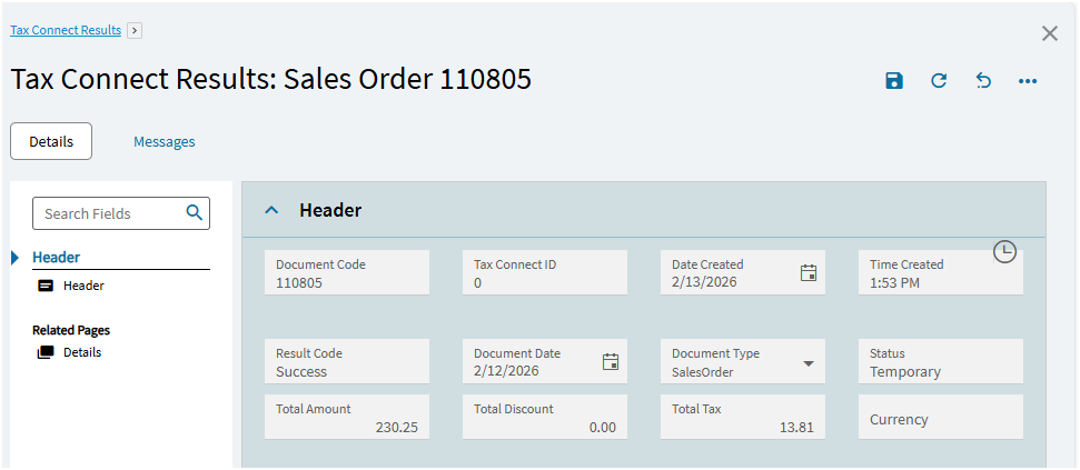

I just did “calculate tax”
This is Production. I found an existing open order with tax and then made it recalculate the tax.
My screenshot showed it was done now (2/13/26 at 1:53 PM [Eastern]).

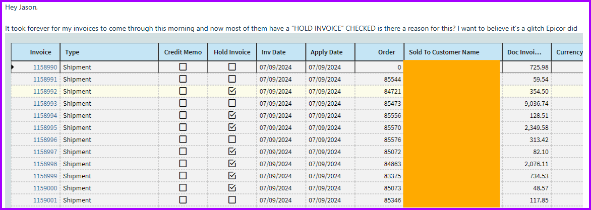

I dug up the old ticket. It was July-October 2024.
The concern (then) was invoicing. It kept putting them on hold when it could not calculate tax. But it was super inconsistent.
And as you can imagine Epicor blamed Avalara, and Avalara blamed us/Epicor.
So, you know, give it 3 months and it should fix itself.
