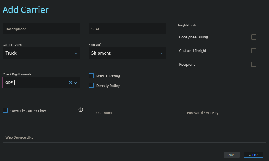

No, it was not added and I will need to use Generic Carrier. But it looks like they do have some sort integration with them as they have them as an option for the Check Digit formula as shown in the screenshot. I was hoping someone had done this already so I wouldn’t have to read a novel to figure it out. But I guess I will just start reading through everything and hope for the best.
We just have Old Dominion as a generic carrier. Add OD under Setup > Generic Carriers. Then go to Setup > Facilities > Edit your facility > Carrier Information > + > select your generic carrier you created. You can then create ship via codes that link to that generic carrier. If you’re integrated with Kinetic you can create them and sync them over.

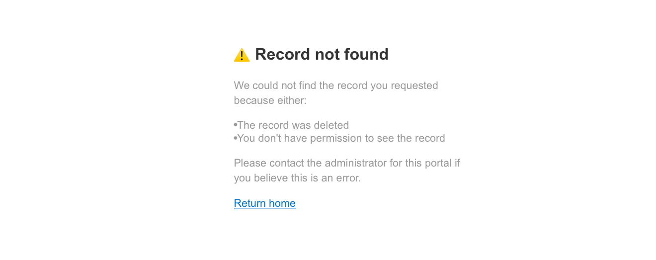

What’s the idea number? That link doesn’t work for some reason.
I hope this is it. I don’t spend enough time on the ideas website.
Edit: QS-I-98 Sorry reversed the numbers the first time.
That didn’t work either lol. Is it a locked idea? If you screenshot the idea we can tell if it’s locked.
Sorry I reversed the numbers. I edited the post but its QS-I-98
