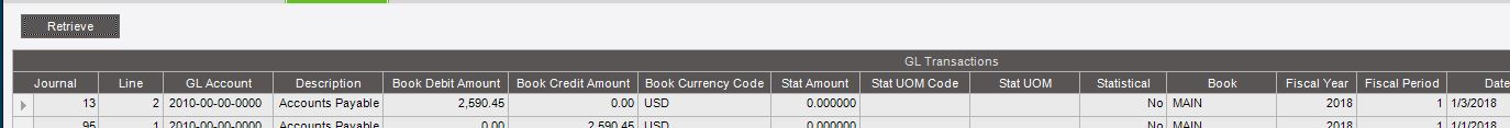

Here is a screen shot of the Invoice Settings as well as some of the actual Invoice in question.
When the Group was created the apply date for it was entered as 1/3/18.
The apply date on the Invoice itself was set for for 12/29/2017.
The GL transactions hit on 1/3/18 based on the Group apply date, but when you view the Tracker you just see the Invoice level apply date which doesn’t appear to do anything in this situation.
