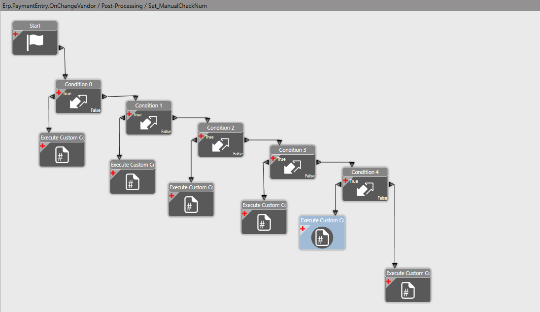

I have been tasked with this code review for months, and I’m just not even sure where to start. The way it was written was a little brute-force. Here is the layout:
Each branch is just a different Company. The “ceiling” for automated check numbers for each company has been updated manually as required over the years. This happens whenever the code breaks due to manually-entered check numbers causing it to reach the limit. Here’s an example of the script:

Does anyone have any advice on where to start with this?
Yes, does look a brain teaser… handling both manual & automatic numbers… for multiple companies.
My only thought, rather than hard coding numbers
I prefer storing my “last used” number(s) in either UD Codes or UD Fields.
Quicker to look up ( I think ) and you can also give a user(s) the option to “DIY” fix a sequence that gets out of whack.
