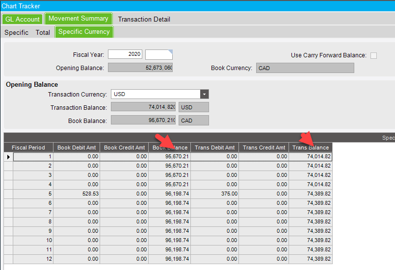

I feel like the source amount should be slowly drawn down at the end of amortization period. but the transaction currency increases every time deferred expenses are setup (by utilizing Transaction Currency filter in Chart Tracker), and does not decrease due to the amortization is not doing at source currency.
