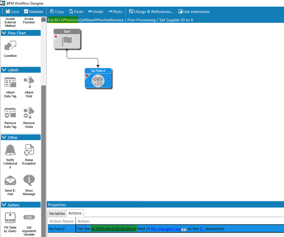

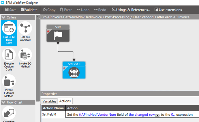

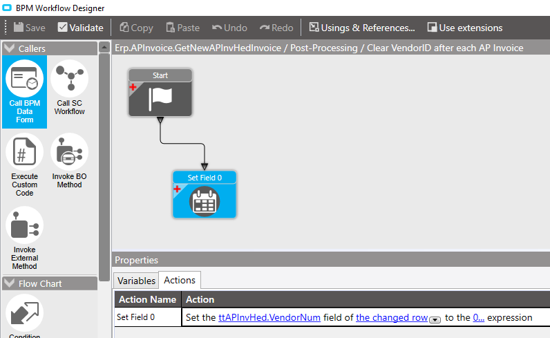

I ended up using a Post-Processing BPM on the method APInvoice.GetNewAPInvHedInvoice - it just needs the VendorNum to be Set to 0 using a widget.
@markdamen any chance you can screenshot the BPM so I may copy? I tried to set a BPM to do this and it’s not working. I must be missing something.
@markdamen thank you so much, I can’t for some reason get my tt table to pull in, the ds table does. How do I go about getting my tt table as a choice?
Epicor switched from tt to ds so you are in the right place.
This is literally frustrating. I have copied everything the same and it won’t work for us on Kinetic 2021.2.11.
Unless you see something different in the screen shot. @markdamen @gpayne
@Andrea I have 21.2.10 in testing now. I will throw this in and check.
Great - thank you
@Andrea Well, I can confirm it does not work any longer. Just after get new invoice header in the trace file ChangeVendorID is called with the text value of the current vendor as the proposed value. So even with a VendorNum of zero it rereads the vendor.

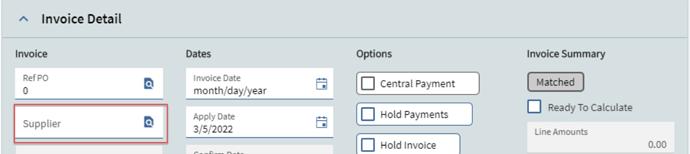

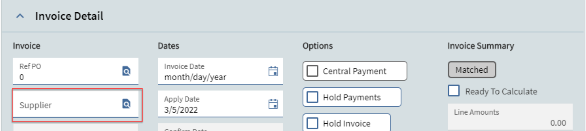

In the new Kinetic UI - Supplier ID is blank when you create a new invoice.
