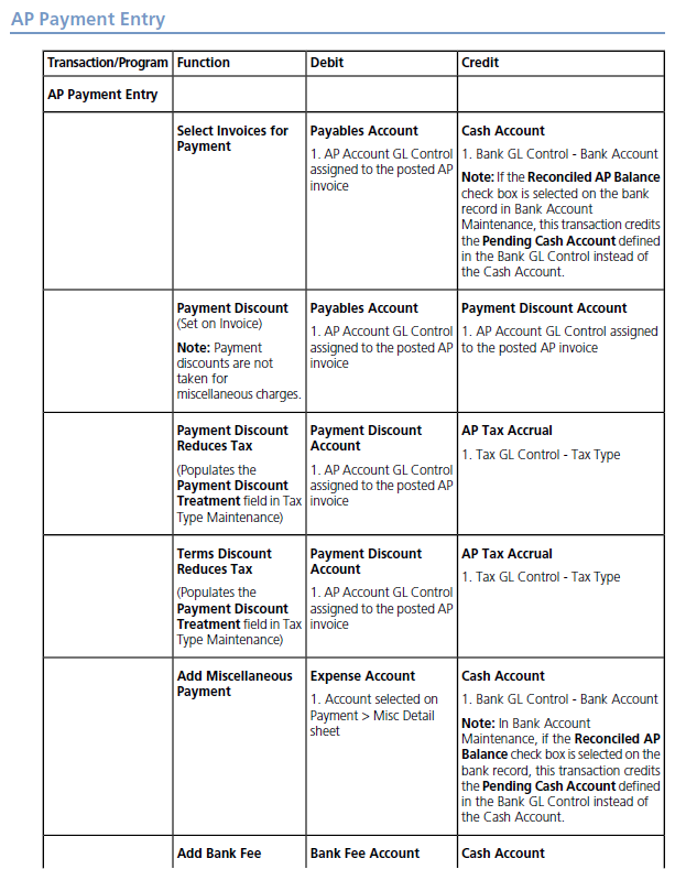

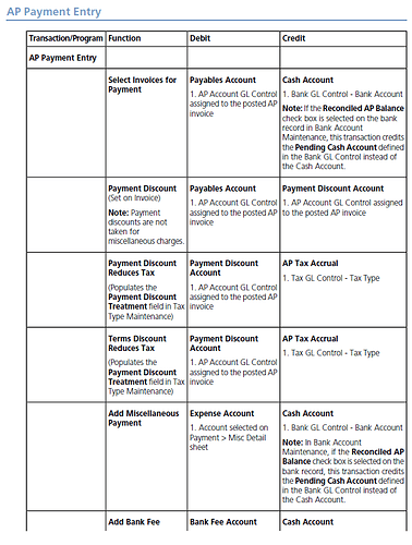

There is an AP tech ref guide on EpicWeb and this is page 1 of their explanation, for example. It will show you what is supposed to happen.

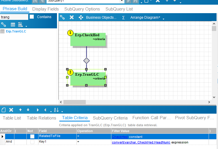

Well you might need to become acquainted with the lovely TranGLC table.
So you’d make a BAQ connecting TranGLC and CheckHed on Company and then criteria on TranGLC of Key1 = HeadNum* and RelatedToFile = CheckHed
*Actually you’ll convert HeadNum (an int) to a string, so it’s really:
Key1 = convert(varchar, CheckHed.HeadNum)
Like so:
(I filtered CheckHed to the last 2 weeks just to test it out.)
