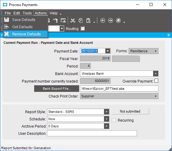

Close Process Payments and Payment Entry and re attempt. you won’t receive error anymore.
Just saw this post, thanks Manny, but I solved it another way. I went to actions and removed and clicked on Remove Defaults, closed the process payment form and reopened. Tada… The Check Print Order field was populated.
If your Check Print Order Field is empty the above error will be generated.
Thanks @Hally that helped us today too!
+1 @Hally, you just helped another unfortunate soul (Ver 10.1.500)
