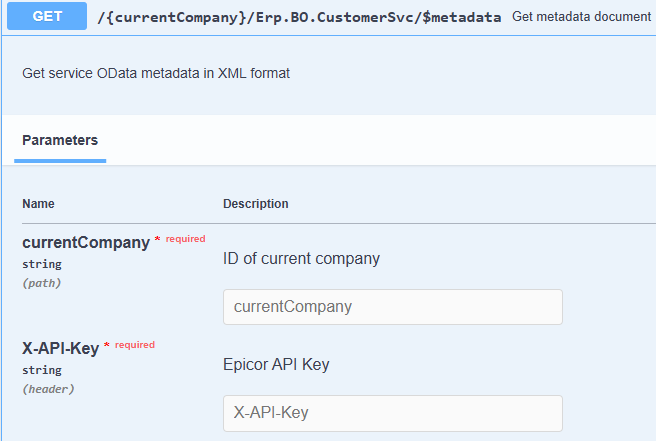

One thing to keep in mind is that the api help swagger page will not perform very well with large responses, so you may be seeing a bit of a delay there.

Have you tried this in Postman? The rest help / swagger sometimes misbehaves.

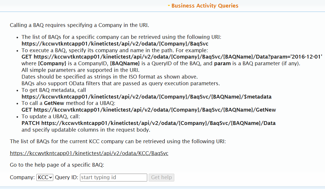

So how do I expose the BAQ to API? Will it automatically show up here in swagger?
If it is shared I think.
Running a BAQ from REST follows all the same rules that running it in the browser client. It respects the Share status as well as the Security ID protections. If that user can run it in a browser then they can run it from REST.
