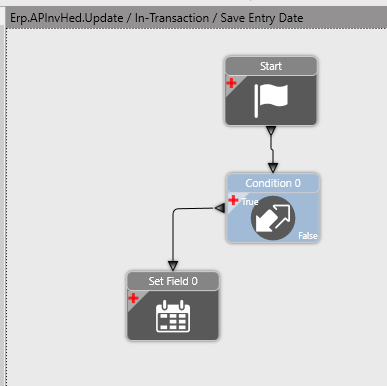

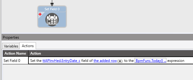

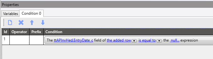

ckrusen
(Calvin Krusen)
5
We added a UD field for that very reason. And an In-Tran DD to auto populate it (we assume it’s being entered on the date it was received.
