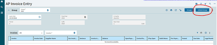

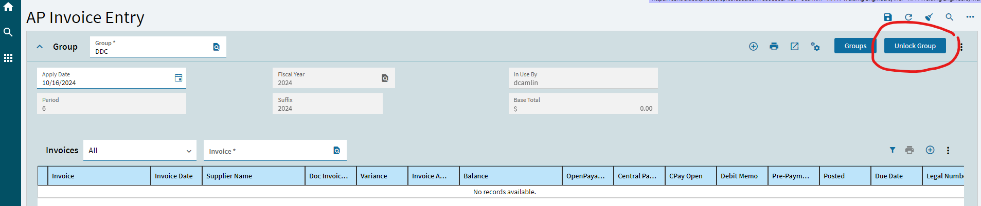

Well, in Kinetic I can see the Lock/Unlock button (on the Group Level).
The button doesn’t appear until you create/load a group.
In Classic, I’m having trouble finding it.
