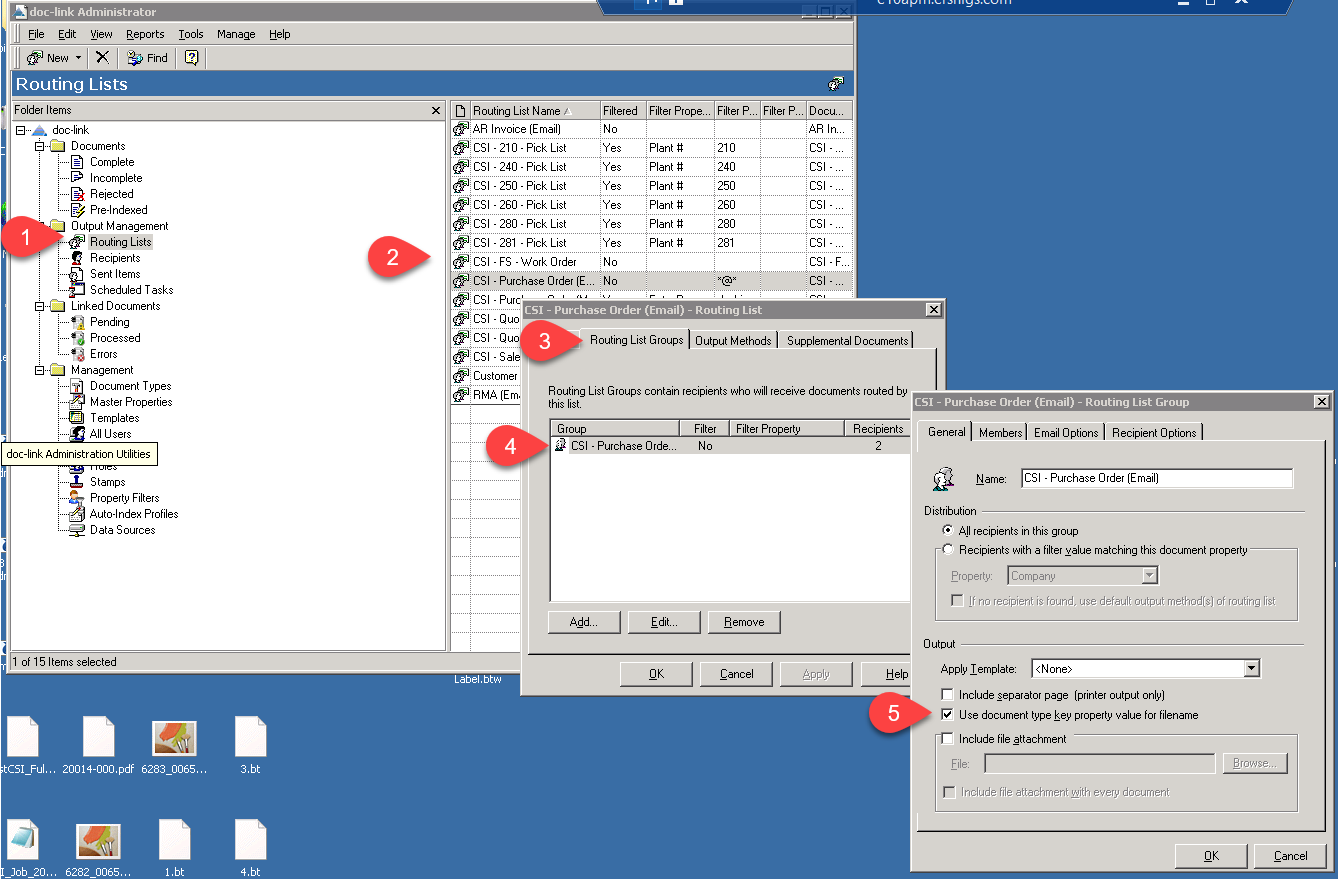

Anyone know if it’s possible to rename the attachment on the outgoing email that APM creates?
Right now it’s some random string, but I would like it to be one of the master properties.
Yes it is possible in version 3+
It is in the Routing List -> Routing List Groups -> Edit -> Use Document Type Key…
[/uploads/default/original/2X/c/c6e39bc0bf45d64ffc6db579bc78270652fcd03c.png]
Let me try the screenshot again
Thanks.
Got it working.

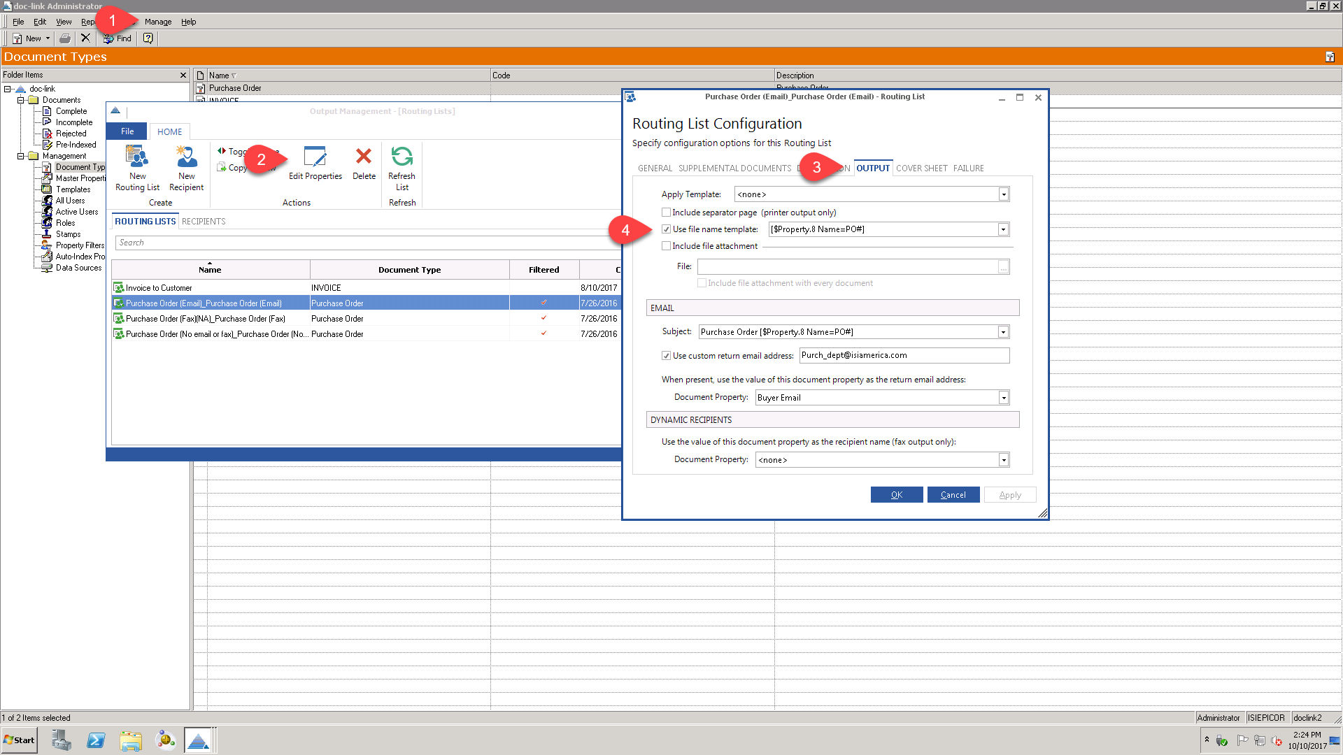

Screenshot for anyone using the newer version of APM (same process, different location)
