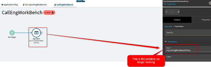

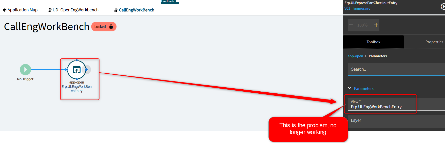

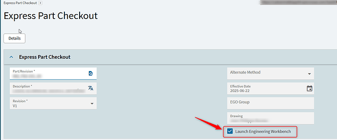

Since the last couple of weeks, gradually, a lot of vanilla buttons/events started to throw errors when trying to launch a menu. For example, the “Express Part Checkout” menu has a “Launch Engineering Workbench” option, which throws an exception of type "There is no active menu available for the app Erp.UI.EngWorkBenchEntry and layer combination.

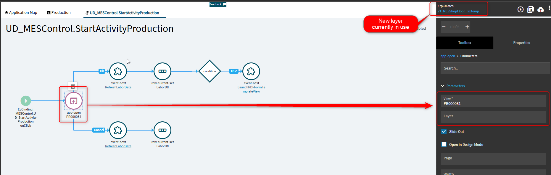

Now, the rather important “Start Production Activity” button on the MES throws the same error:

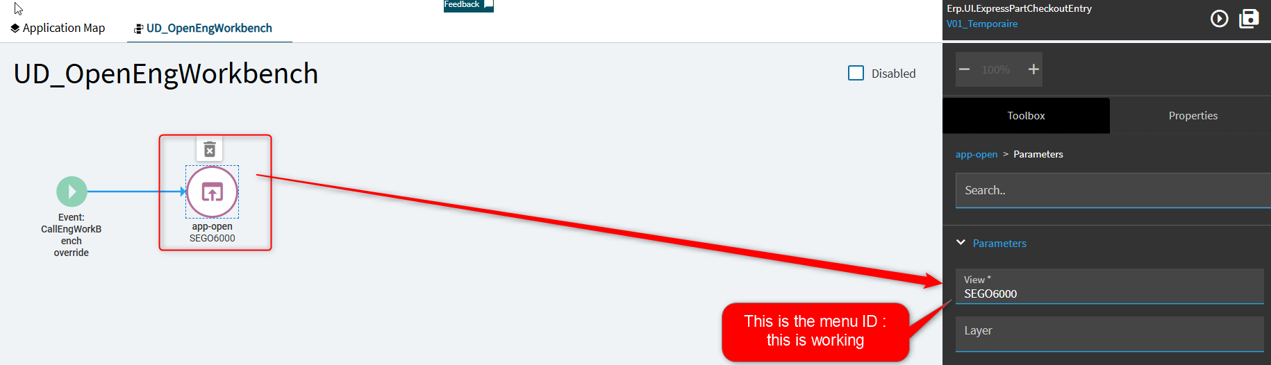

When our admin told me about this, I quickly opened App Studio and “overrided” the vanilla “App-Open” event/widget. Here is the quick fix we implemented:
We implemented the same thing with “Start Production Activity”:

  1. As quick fix, we created a new customization layer on “MES” and modified the “App-Open” widget of “On Click” event of the “Start Production” button to call the menu ID instead of the application name. Here are screenshots of the original customization layer : (3 attachments)
