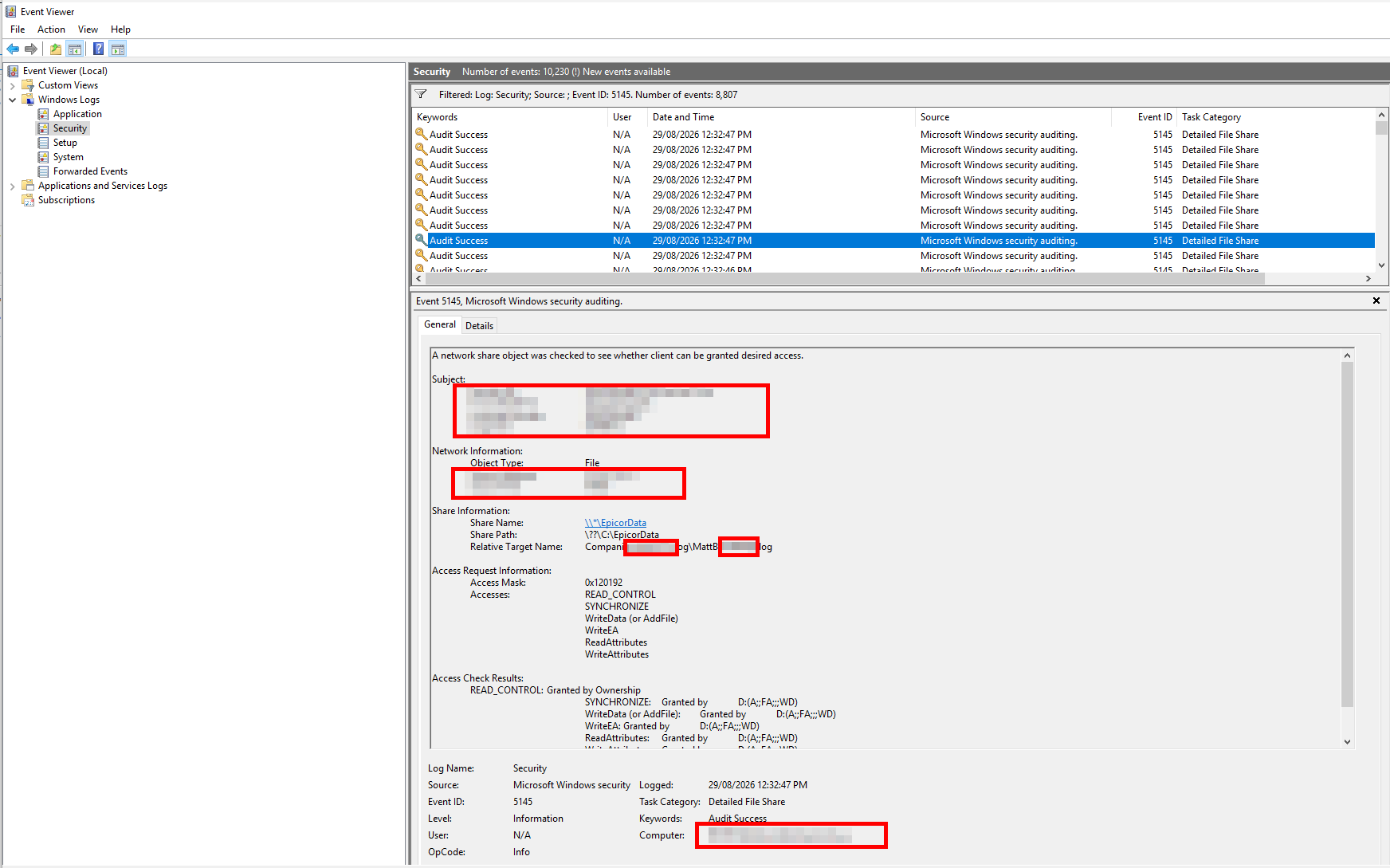

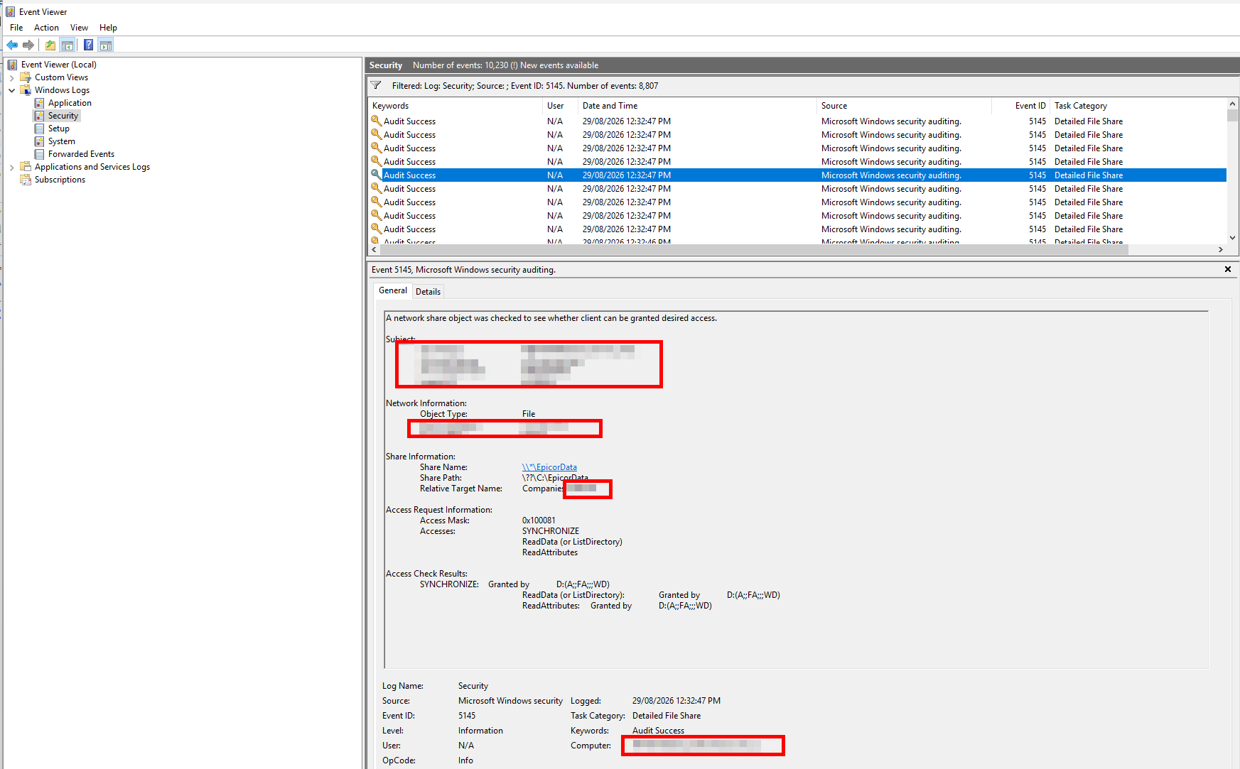

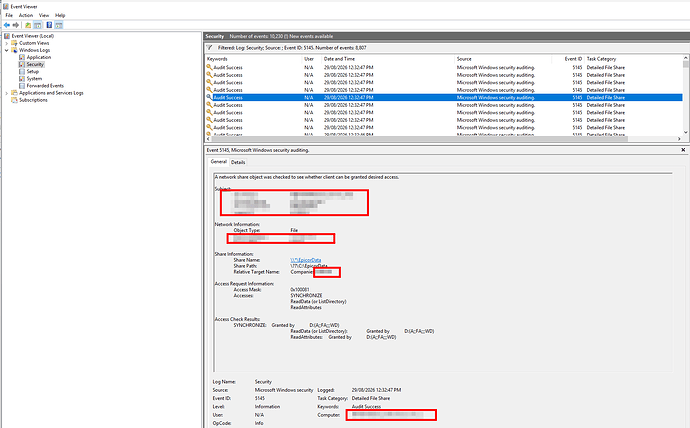

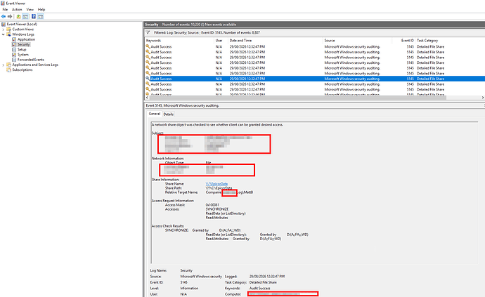

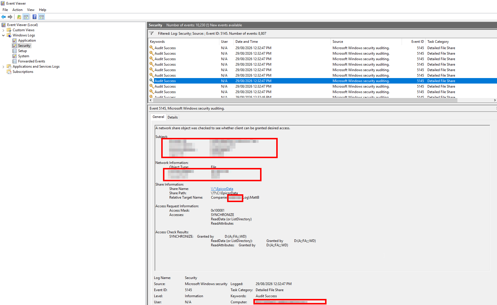

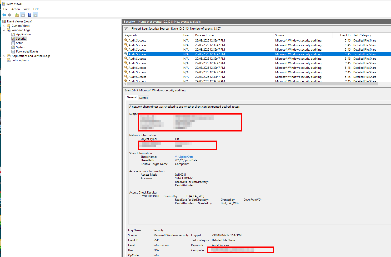

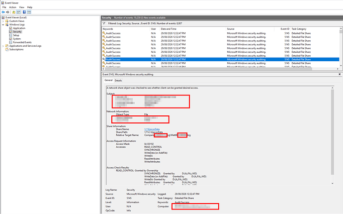

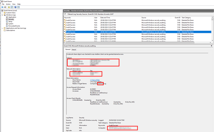

Screen shots of the messages. I got ~150,000 events in about 2 minutes, well over my 1000 per second guess, and it seems to get slow when it reaches the “Maximum Log Size” and has to start overwriting the old events.
Resource Monitor shows the disk activity is…a lot. I’m pretty sure the read/write hit ludicrous speed for a few seconds there. Active time on C:\ hit 99% frequently, and the disk queue length got to ~1.5 or more several times. And most of that means very little to me. But when MRP stops, it’s like the million voices that were crying out are suddenly silenced.
Running MRP without logging means the disk activity barely registers, but network traffic is higher…likely a good sign.
