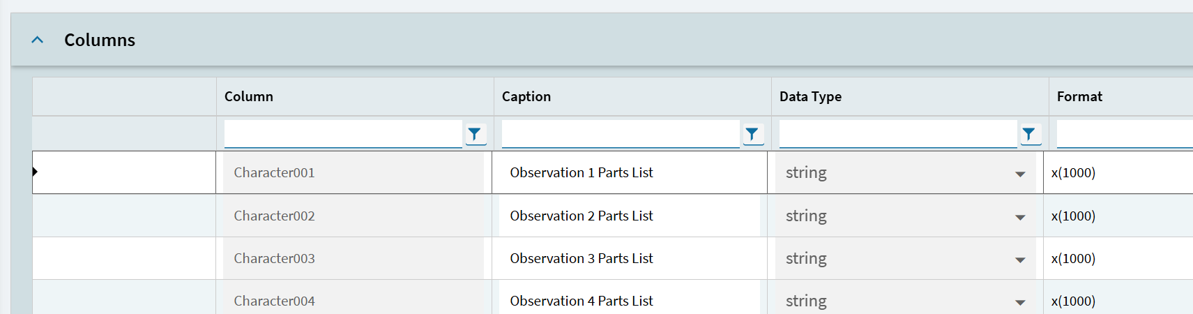

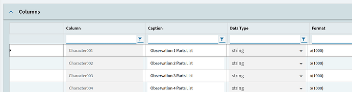

I’m currently developing a custom layer for Inspection results entry to replicate what we currently have in the classic configured inspection plans. Early days as there’s a lot of pages to be built then a lot of data rules to be applied.
I’m wondering, to save myself time and to future proof this. I’m wondering, is it possible to show the Dataview Caption in the field label? e.g. in the example below, if I bind a combobox to ResultsEntry.Character001, can I get the combo box label to show “Observation Parts 1”

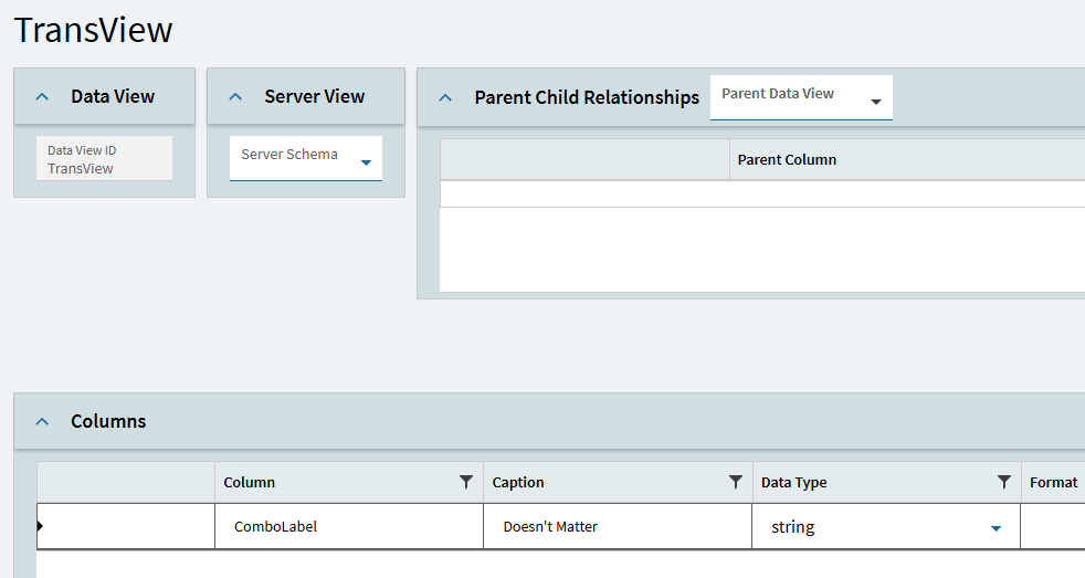

Here’s a rough example I threw together…
In my TransView dataview, I added a column called ComboLabel.
After TransView is initialized by the application, I row-update a value into that dataview.column:
And finally, I created an onCreate event with my combobox, so when it is painted on the screen… the property-set action changes the label of the combobox to whatever the value of TransView.ComboLabel happens to be:

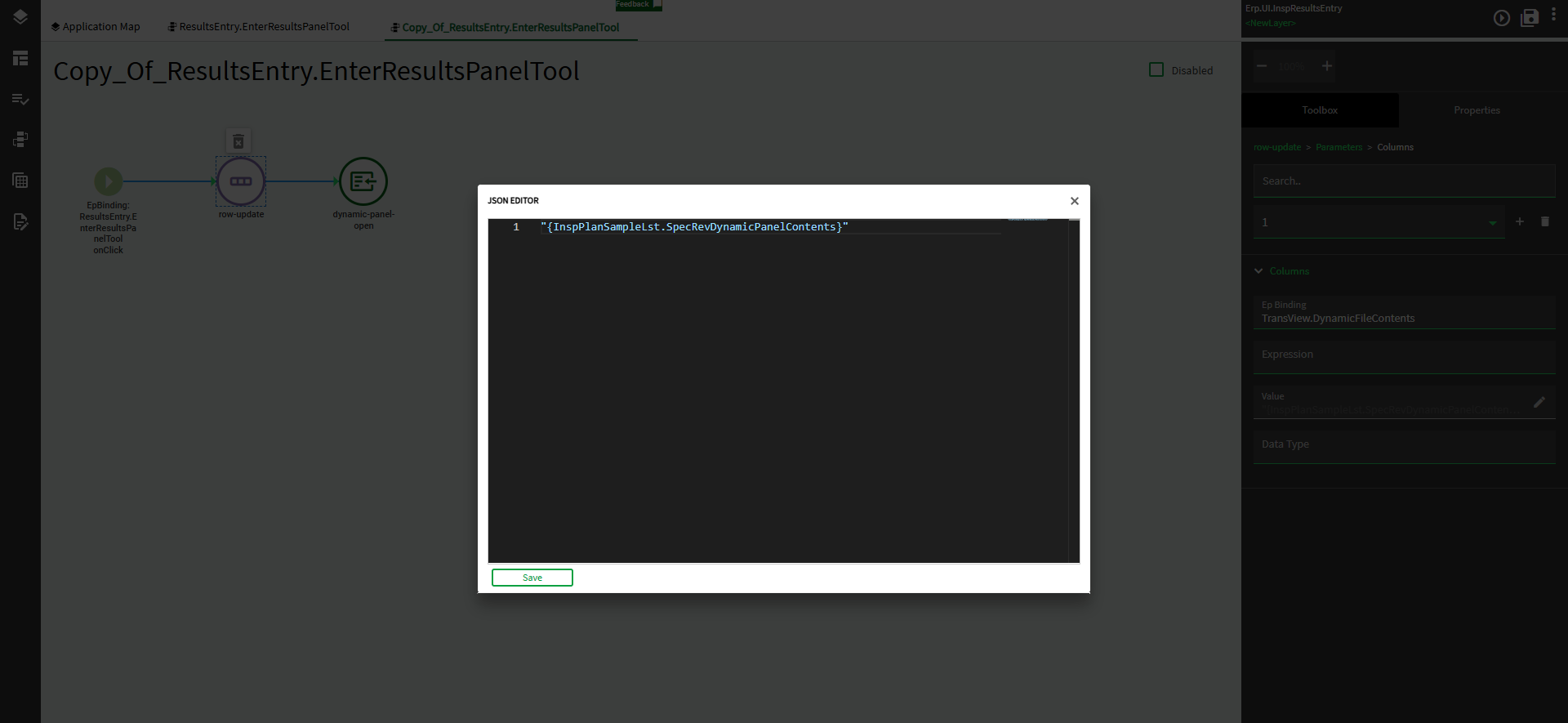

You might also want to checkout the Dynamic Panels features too like so:
Could conceivably write dynamic panel json in Erp.BO.InspResultsSvc/GetInspParams POST-PROC BPM. :man_shrugging:
