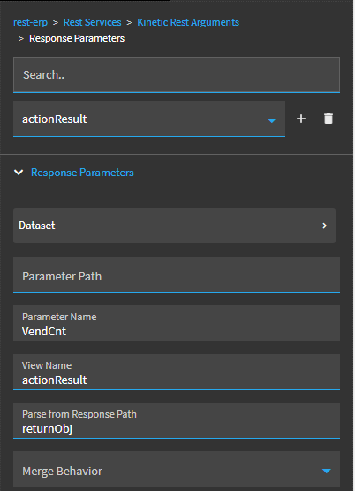

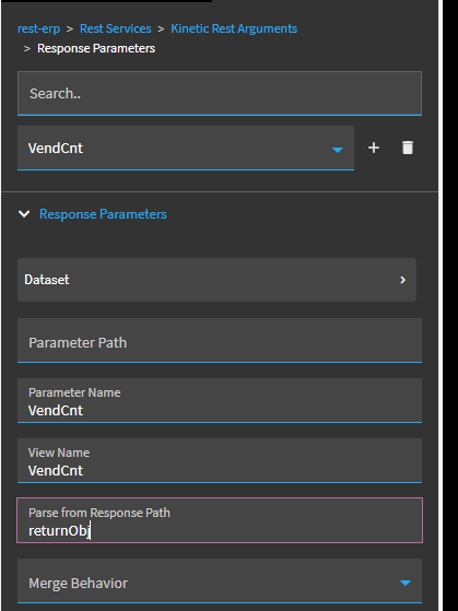

The rest call appears to be working. I get the response I expect:
but can’t get it to load in a view (VendCnt or actionResult) or figure out how to get the returned EmailAddress directly into DMRHead.ConNumEmailAddress.
After the rest call completes, I see no records in Dev Tools epDebug.views in the view being attempted.

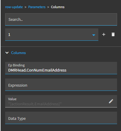

I’m assuming a row-update is next. Tried this:
With “{actionResult.EmailAddress}” in the Value field.
What am I messing up?
