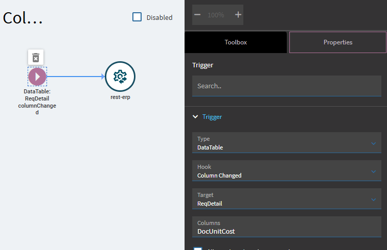

I have a Column Changed event that sends the ReqDetail dataview to a function. This works, but my function has the old data from the dataview instead of the new values. How do I get this to trigger once the dataview update is complete?

What I am looking to do is get a total of all the requisition lines. My thought was to use the column changed trigger on the DocUnitCost column and then send the ReqDetail dataview to a function. Also tried passing just the ReqNum to a function but seems to be a timing issue with the Column Changed trigger.
Is there a different way to trigger this event after the column change has completed?
