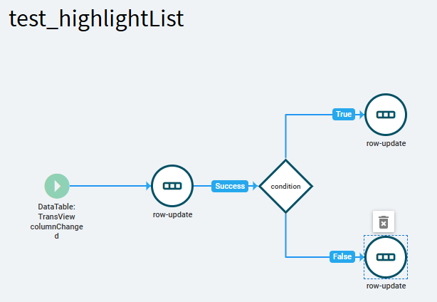

I’m not sure how you’re compiling your list of CustNums… but if you can store that list value in a dataview.column, you can then combine an event and a Data Rule to do what you want.
Here’s a quick example… I used PartNum instead of CustNum, but that doesn’t matter:
I set my trigger to be based off my target column changing value, so it is evaluated each time. column_changed
My first row-update creates my list. In my case, I just added it manually.
The JSON is just a couple part numbers surrounded by tildes.
Next is my Condition:
Expression: '{TransView.MyFilterList}'.includes("~" + '{TransView.PartNum}' + "~")
So, if my filter list includes “~” + “{my TransView.PartNum value}” + “~”…

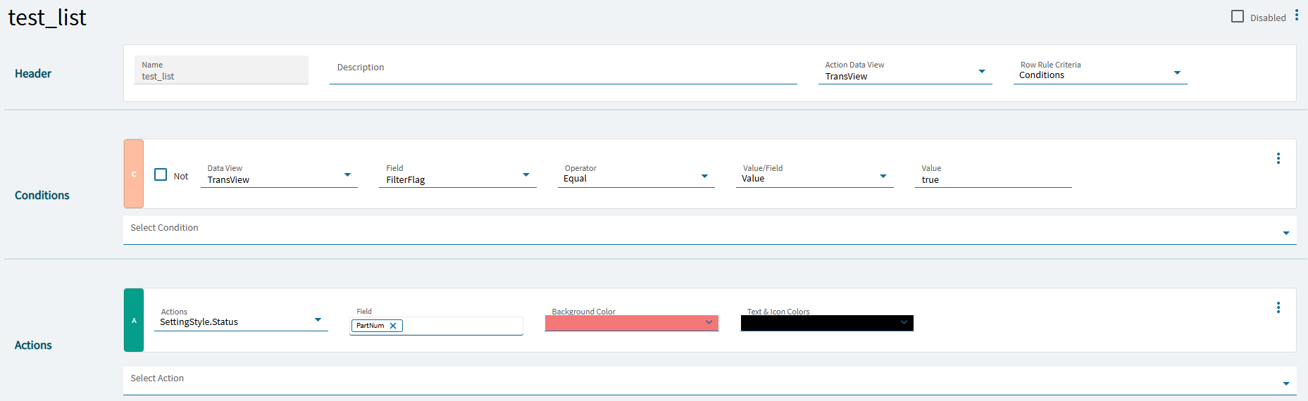

If TRUE: Row-update TransView.FilterFlag = true (just a simple made up boolean)
If FALSE: Row-update the same TransView.FilterFlag = false
Now your data rule is simple… if TransView.FilterFlag = true… highlight my textbox.
(I guess you’d have to add an AND condition here to include your PONum condition)
You’ll also want to add a second Data Rule, to turn the highlight OFF if your CustNum value changes and everything is re-evaluated.

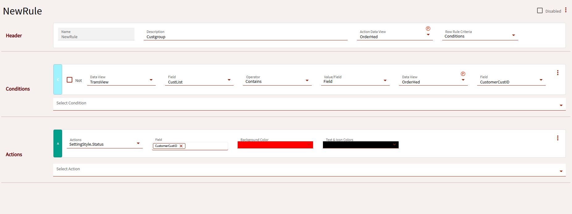

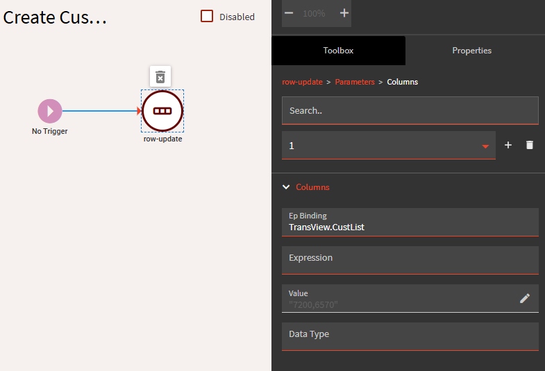

You could try updating a row after the form loads to contain your list and then use the ‘Contains’ operator when setting up your rule.
Here I create TransView.CustList to hold my list.
Then you can check if your customer list contains the CustNum in your rule.(I used CustomerCustID instead of CustNum in my case)
CustID is in my list.
CustID isn’t in my list.
