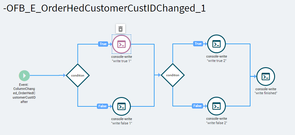

I have a need for a custom event handler with structure such as this:
(this is simplified with simple console writes for testing and explanation)
App studio happily lets me draw it this way, but when I debug/trace, it clearly show the first condition and first console-write executing, but it then just stops…doesn’t execute the 2nd condition.
Has anyone had success with such a scenario ?
Couple of interesting/annoying things:
If I save, close, reopen, it looks the same

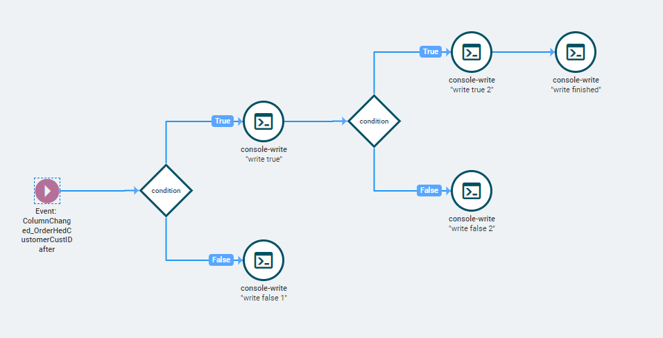

But, If copy it, it now looks like this:
This makes it obious why it stopped since my first condition was false.
This tells me also, it’s likely not intended to work, but it drew the graph so nicely as I wanted it to

I can get an event built like your second screenshot to work (branching conditions) … but never converging branches like in your first. It appears that the only way is to use event-next and continue the path in a separate event that both branches call…
If it really is the only way, then App Studio should throw an error instead of pretend that it’s saving as displayed…
