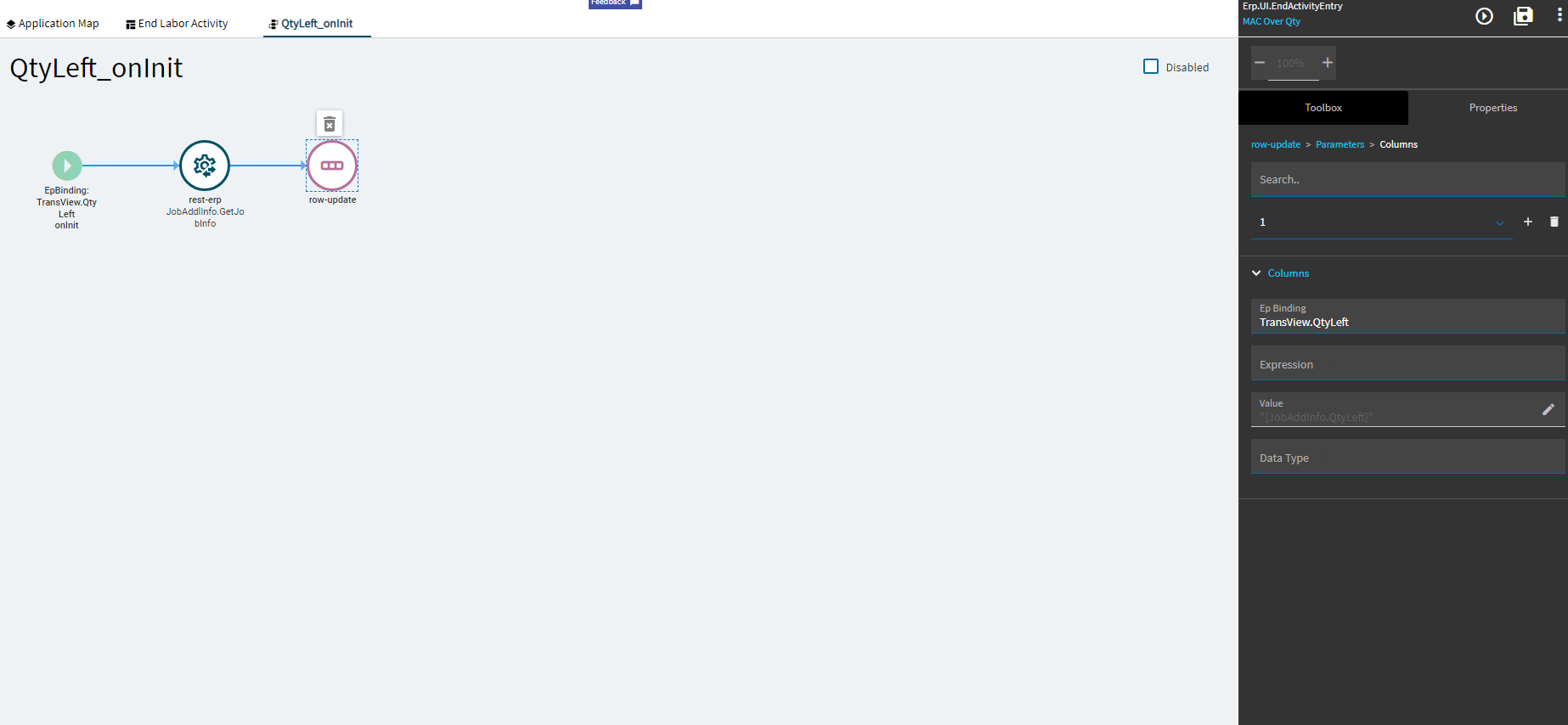

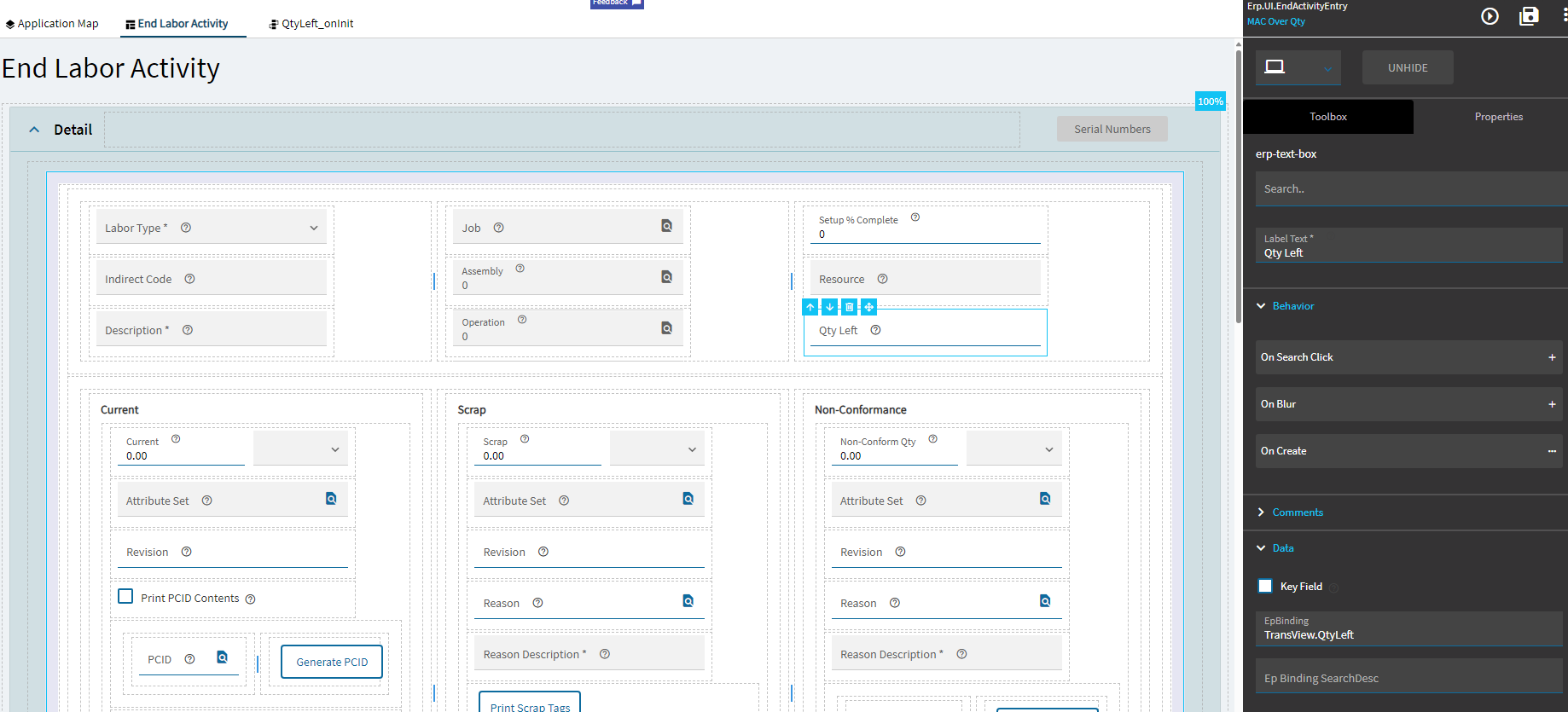

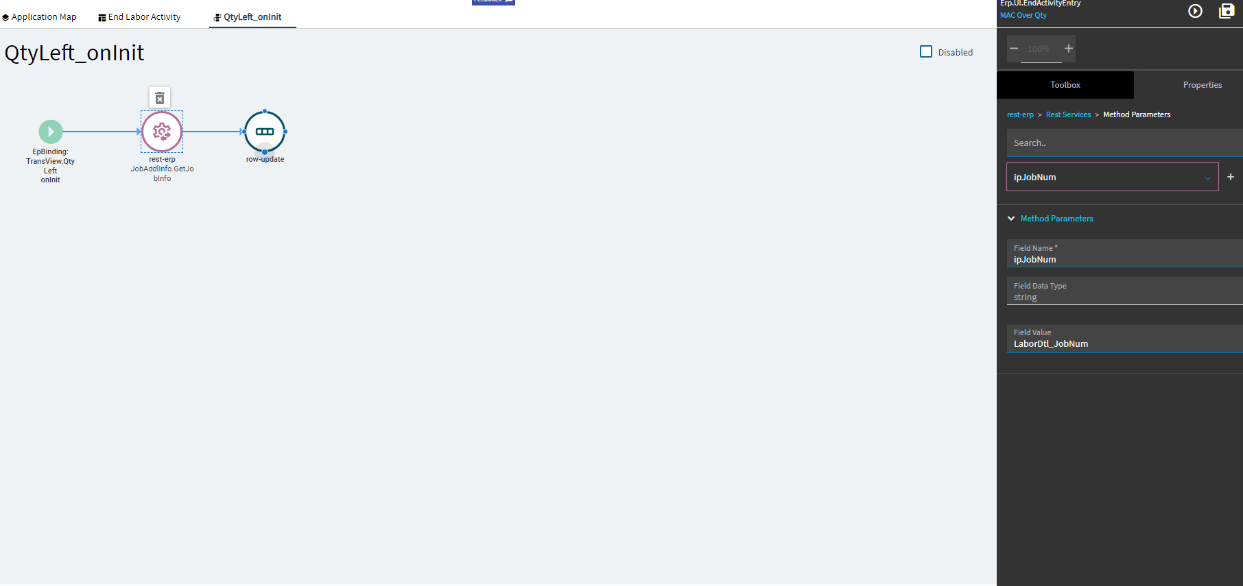

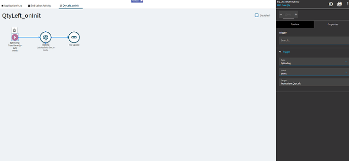

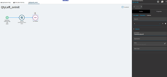

I am struggling with getting the JobAddInfo data to pull into the End Activity screen on MES using a rest-erp. The field I particularly want is the “Qty Left” field.
I followed the thread below, but I am still getting an error:
App Studio - Adding ReqHead Dataview and Rest-erp to Purchase Order - Kinetic ERP - Epicor User Help Forum

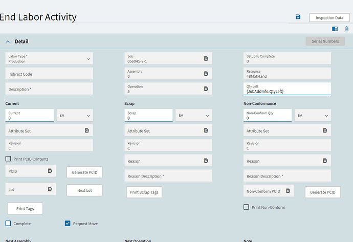

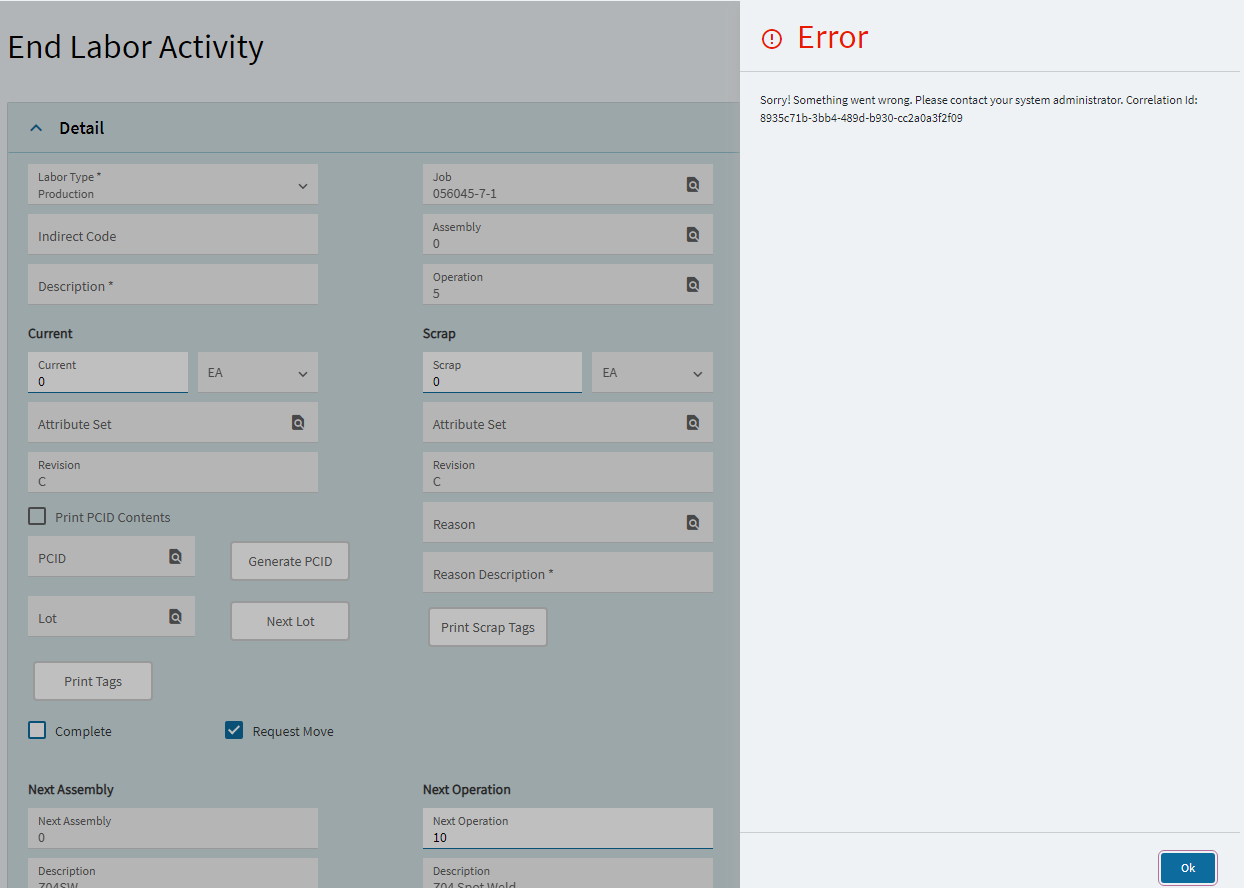

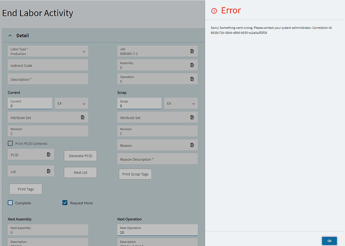

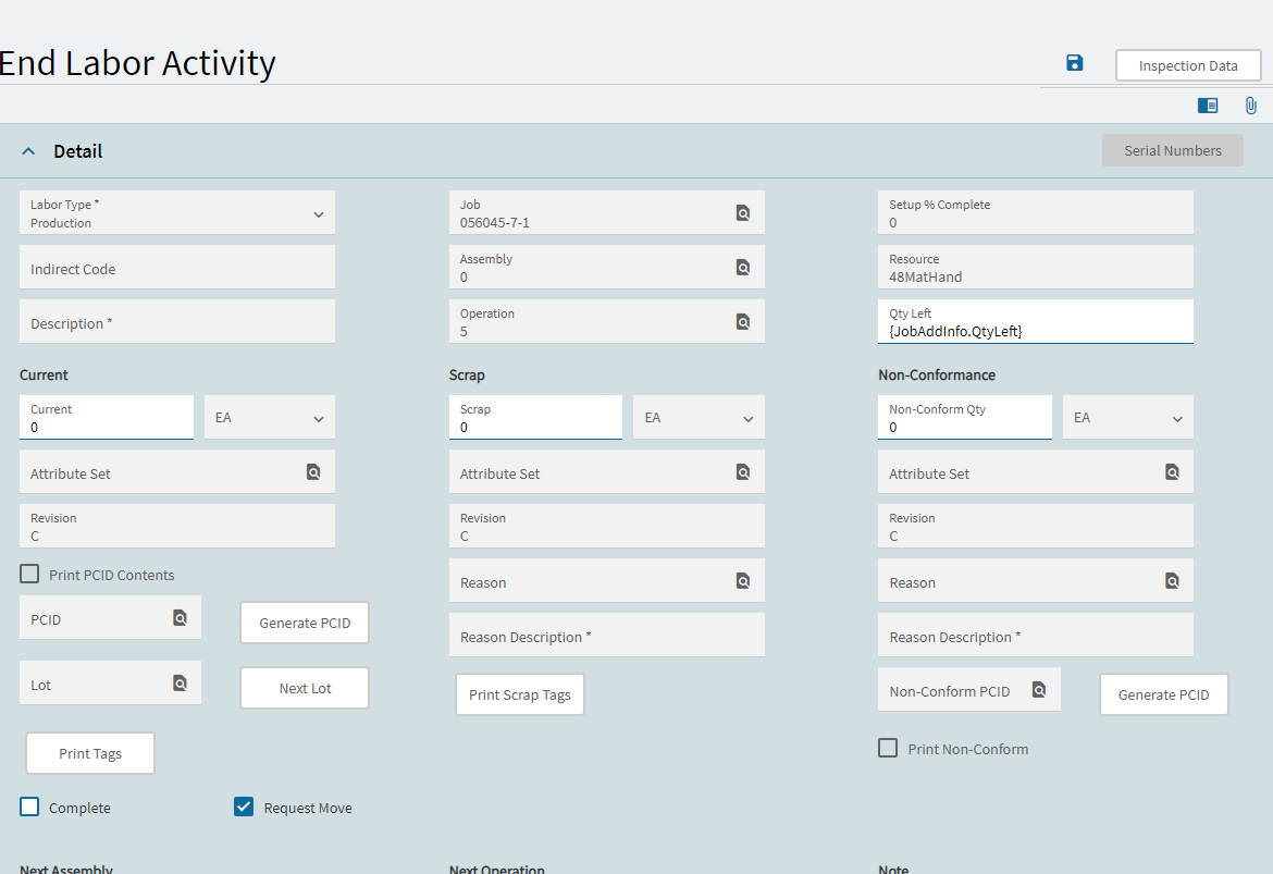

When opening the End Activity screen, I get a correlation ID error. After selecting okay, I can see that a value pulled into my UD field for Qty Left, but it pulls in the string value (Ex: {JobAddInfo.QtyLeft})

Did you set up the ERP Rest Arguments > Response Parameters?
Did you set up JobAddInfo as a dataview to receive the response parameters?
The “value” of your row update has quotes around it, so it’s going to pass a string.
If you take the quotes away, it should pass a number value.
… at least that’s my first thought.

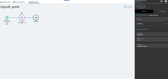

Also, as @hmwillett mentioned, reviw your rest request & response. Make sure you check if there are more than 1 parameter that needs passed. I often fill in the first one (ipJobNum in this case) but forget to check if there are additional ones that need accounted for. Since this is being used to end production activity, i wouldn’t be surprised if there were additional parameters for AssemblySeq and OpSeq. Not by a computer at the moment to check, sorry.
The quotes are required in the value field. That shouldn’t affect the value as long as the view exists.
I suspect the JobAddInfo Dataview wasn’t created and therefore there’s no value to pass, so it defaults to the literal.

I will double check this. I think the issue I was having is that I would set up a dataview, add columns and what not, but when I would save and refresh, all my columns would be gone. Is that normal? Am I not supposed to create columns but just a dataview to call to? I apologize for any ignorance, lot of my Application Studio training is self-taught.

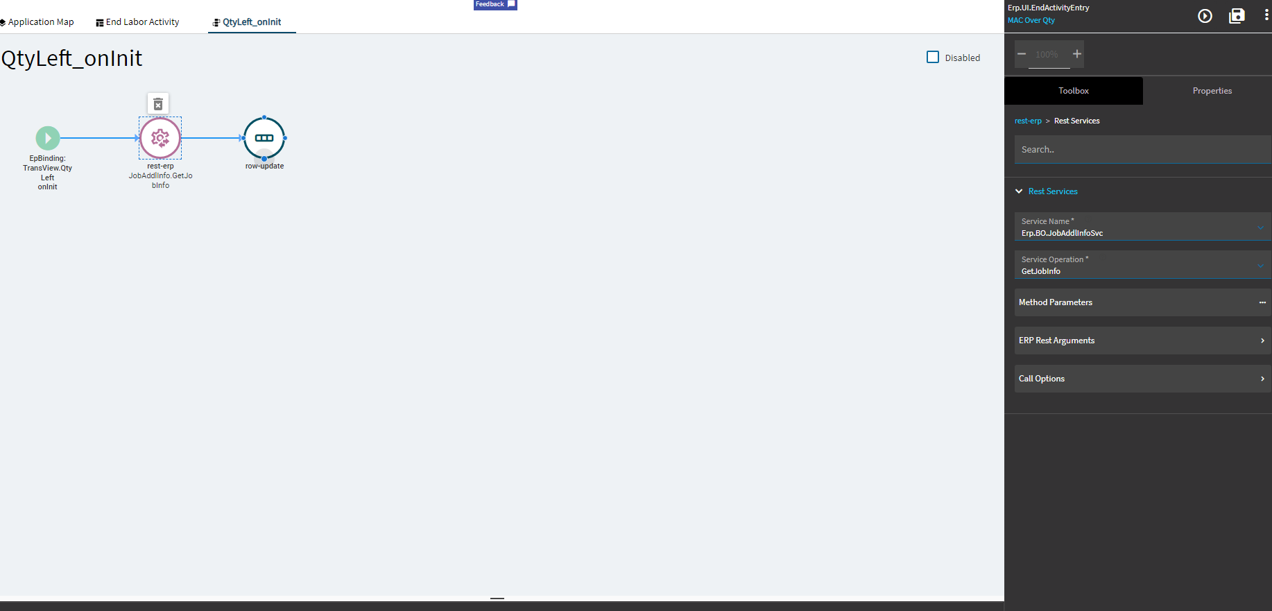

The columns should come in by themselves when you enter the Data Table in the DataView setup… you shouldn’t need to add them.
I believe this could be your problem…
The table you want to be referencing in your DataView is JobbAddlInfo, but you may have put JobAddInfo.
Not “Job-Add-Info”… but think, “Job Additiona L Info” : JobAdd-(lowercase L)-Info.
Check the Data Table used in your dataview for that missing L and see if that brings in the columns. You’ll have to double check all your bindings to make sure you get that L in there, as well.
I was able to get it to work!! @dcamlin and @hmwillett were both correct.
I created the DataView for JobAddlInfo and made sure to update my bindings to have the “l” in between Add and Info. I used the Wizard to create the DataView which let me set up the Response Parameters at the start and have events pre-made to edit.
