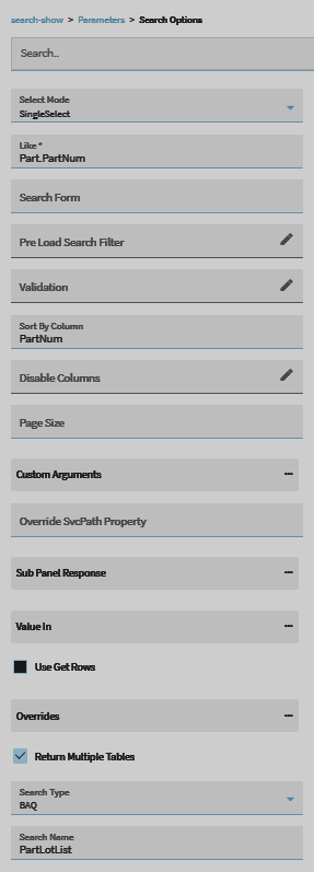

App Studio - search-Show for a BAQ search using default search
Trying to get a search on a field to use a BAQ search.
When clicking on the search symbol, the slider shows the BAQ search and I can select an entry. It populates the first field using search-value-set, but won’t populate a second field with a subsequent search-value-set.
So I use the console to look at the searchResult, and System Dataview > searchResult > Array(1) > 0 appears to be returning the field list from the default Part search, not the field list from my BAQ search.
I’ve tried it with Search Form = default, and the same problem occurs.
