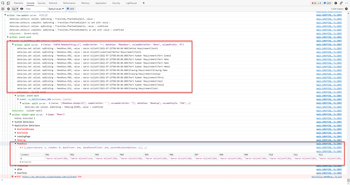

@Ishkaran is there a way to get the split widget to add the split values as rows in the view instead of it adding them as columns?
And if I can get them into rows, is there something I can do to loop through all of the rows to do extra processing?

I don’t know of a way to split them into different rows at the UI level. However, I have always found it easy enough to split and pivot data server side via a BPM and or BAQ when needed. I generally find implementing and supporting data transformations and changes far simpler server side.
Plan B is to use a function to do it and have that function return a dataset which I can bind to my grid.
Plan A is to struggle in App Studio and find creative ways to do things, so I can learn it better.
Trying not to resort to Plan B unless I don’t have a choice.

Regarding splitting the delimited values and adding them as new rows. Would need to somehow glue the split event-action and row-add event action. I will get back on this.
client-side-first is the way if only to learn but also to push at the fringes with hope that more power is granted client-side - or at least not taken away.
