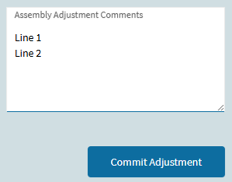

So, trying to put the finishing touches on a dashboard and this is bugging me. I’m giving the user the ability to enter a comment into a TextArea, which is being saved to a ud column.

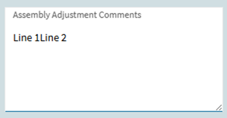

Initially looks good… saves.
If I then re-open that record… it comes back in looking like this:

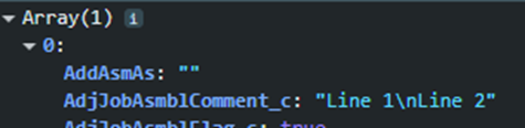

Looking at the dataview, it is being saved as this:
So, it is taking my hitting the “enter” key when entering the text and injecting a “\n” (new line).
What I really need is a “\r\n” Carriage Return Line Feed.

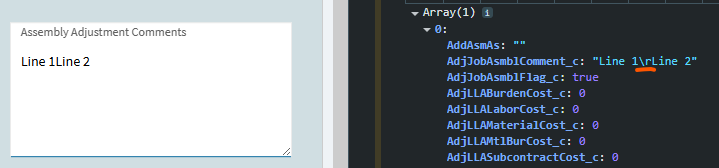

            row.AdjJobAsmblComment_c = row.AdjJobAsmblComment_c.Replace("\n", "\r");
It successfully replaced… But, sadly, the TextArea just seems to ignore them:
Perhaps just a limitation of the Kendo TextArea? Users will just have to deal for now cause I’m tired of trying to work around it.

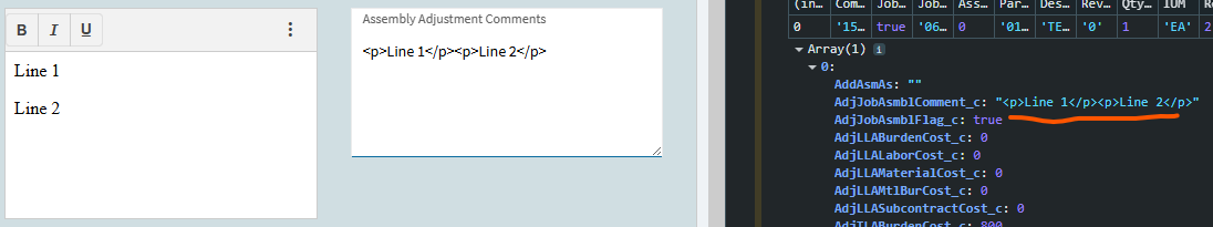

Well, interestingly, the Rich Text treats the stored value to HTML paragraphs, adding < p> < /p> tags to the value being stored in the dataview:
So… although this comes back in looking correct in the display (in the rich text editor) if I reload the record, I’m a little concerned about having those HTML tags included in the stored value.
I’ll have to see how this may effect reports where I try to pull this value in. I may have to add additional “replace” expressions in SSRS to fix them there.

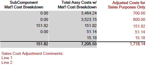

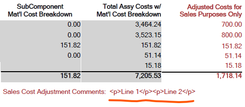

SSRS Output: :roll_eyes:
… and of course, even if reverting back to:
SSRS doesn’t like that:

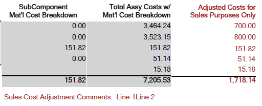

So… guess I need to “replace” in SSRS afterall:
="Sales Cost Adjustment Comments: " + VbCrLf + Replace(Fields!AdjJobAsmblComment_c.Value, CHR(13), VbCrLf)
Still doesn’t fix the Kinetic UI (TextArea)… but it’ll show up correctly on the Production Detail Report. So, I’ll take the small victory at least.

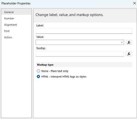

In SSRS, you can set the place holder to interpret HTML maybe?
Yeah, I’ve used that before… but… enough is enough. I’ll wait until someone starts bitching about it in the UI. (you know… sometime tomorrow probably :rofl:)
