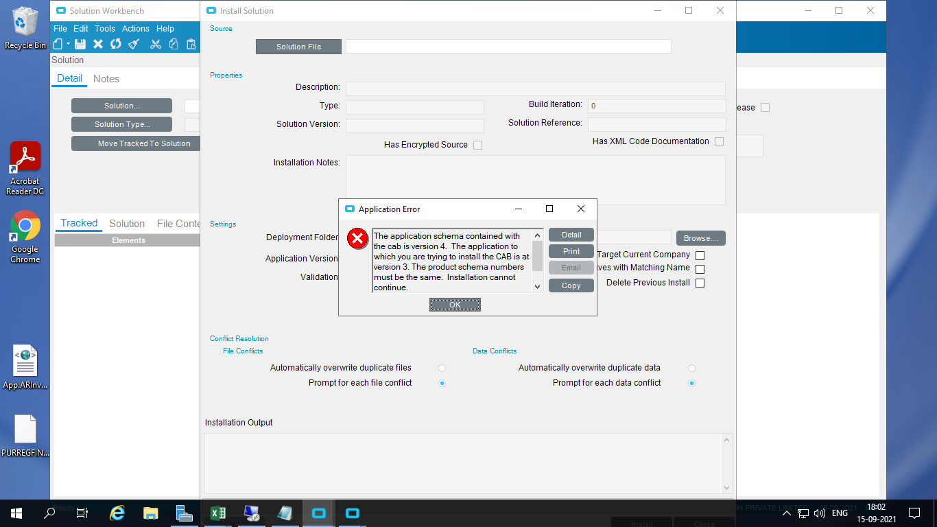

Hi there,
While installing file created in Epicor 10 Cloud to Epicor 10 On Premise, it throws below error
What is this error? And how to resolve it?

It’s showing ICE version is different (3 & 4), Cross check both Environments Version again.
Or try to re built again and install.
