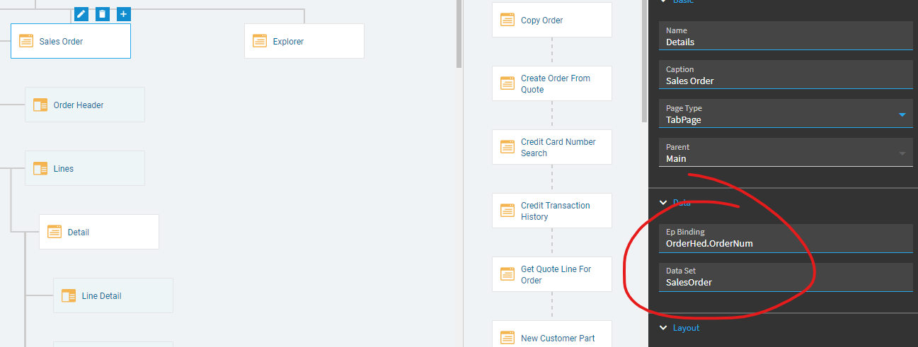

I have noticed now that I have published this that its broken the ‘Breadcrumb’. Any attempt to switch to another Sales Order fails (See screenshot. Clicking any sales order does nothing). Switching between Views on the ‘Lines’ crumb still works normally.

This means application studio gobbled up some data binding you didn’t even touch. Its the worst bug out there right now in my opinion. You will have to compare the data binding for each page against the base form and see which one it corrupted.
Found the issue! Same as what ive seen previously and you’ve kindly confirmed it is a bug and not me being blind! Dataset and Ep Binding was deleted.
Spent many days just deleting layers are remaking over the below aswell if this is affecting anyone else! :frowning: Any changes to the Landing Page can delete the binding on the Tab page
