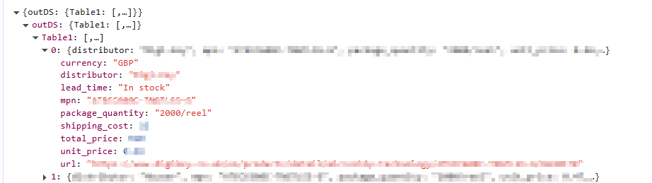

Hi,
I am calling a function from an Epicor function, that returns the following data as a system.DataSet parameter.
"outDS":{
"Table1":[
"distributor":"ACME",
"mpn":"ATECC608",
"package_quantity":"2000/reel"
"distributor":"BAC1",
"mpn":"ATECC608",
I have set up the view in Application Studio as follows:
I then call the function using the erp-function widget and populate the response parameters as follows:
When I look at the response in Chrome developer tools, the data is being returned, but the dataview is not populating. The console is reporting the following errors.
I’ve seen a few posts on here about this, and followed them, but have had no luck.
Can anyone see what I’m doing wrong?
Thanks,
Andrew.

The response is been sent, just not populating the view

Try clearing Parameter Name and then changing Parse From to outDS/Table1

Tried
and
still no data in the view.

In your second screenshot clear parameter name so it’s empty
aclements
(Andrew Clements)
April 17, 2025, 10:23am
9
Thankyou so much - that works.
