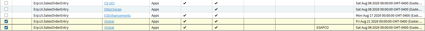

Application studio is showing 2 rows of our ‘Global’ Order Entry layer.
My first thought was to see if there was any difference between the two. Turns out that you cannot select them individually. Export also seemed to only contain a single Global.json file.
As the name implies the layer was designed for ‘global’ use. Not sure why ESAPCO in the company column is present.

In my application studio I have a base layer, and a single published layer on top of that. In my published layer it shows a weird company name that is not our name (but does include our site ID). I assume this is a temporary account Epicor used during some transition. In the application studio grid view, turn on the status column by going to the vertical … and choosing personalize columns, and check off any that aren’t showing. Does this give you any more information?
I know back in the day you could save a dashboard per company. May that is the same for a layer.
Status was the only missing column but no additional information presented itself. Thanks for the suggestion!

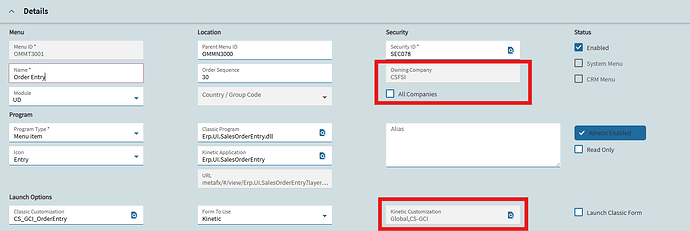

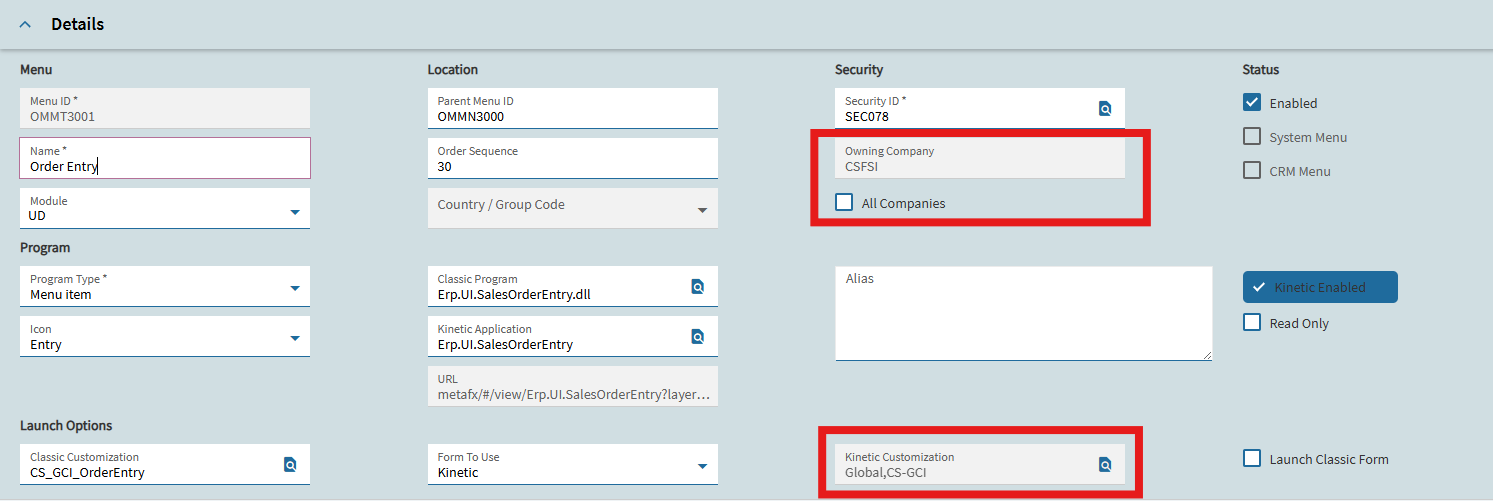

Good to know. Prior to this issue I was only aware of Menu Maint. company controls along with the usual customization (layer) selection shown below.
While trying to duplicate the ‘Global’ layer in our testing environments it did seem to show that both Layers and Personalizations can be company specific. Thanks for the callout @knash !

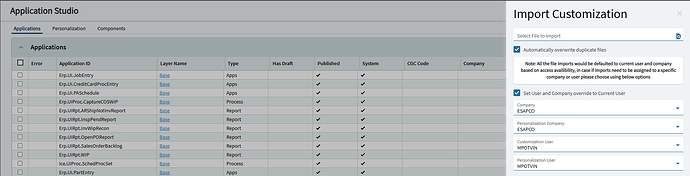

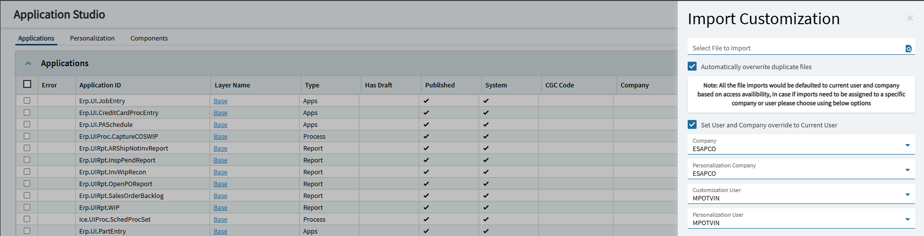

3. So, in Kinetic 2025.2, I believe, Development Enhanced the Application Studio “Menu” Import process - to allow a Imported Kinetic Customization to be setup for a Specific Company, which is the “Default”
4. Because Solution Workbench uses the Application Import/Export features, Solution Workbench was also enhance - to match the Import Enhancements made to the Application Studio Menu. And again, the Default Import setting is to flag the custom items for the Company you are in
NOTE: In 2026.100.11, the Application Studio Menu’s Import Process has been enhanced, so now the Default Import option is set to All Companies.
