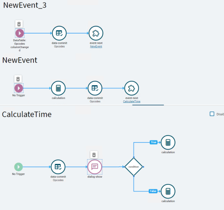

I have a window I’ve made in application studio. In order to make it update the information in each row as the numbers are entered I have an event that triggers on column change(So when a user presses tab) that triggers the other events.
It works as intended until the third event, “CalculateTime”.
If I get rid of the dialog-show, it does not work. The Calculations don’t actually go through and get put in the next field. The dialog show can be anywhere before the calculation and it will complete without an issue, but if the dialog is not in there, it does not complete the calculation.
It has to actually have a type/message in the dialogue, if it does not pop up, it won’t work. I’m wondering if its a synchronous issue? and the dialogue box is giving it enough time to catch up.

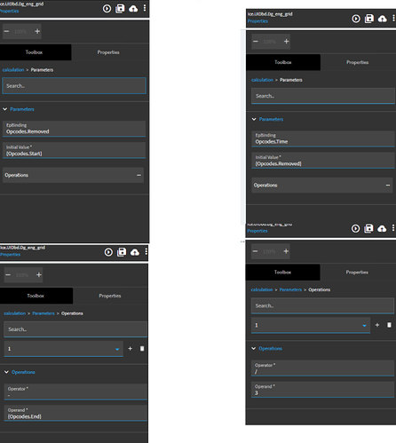

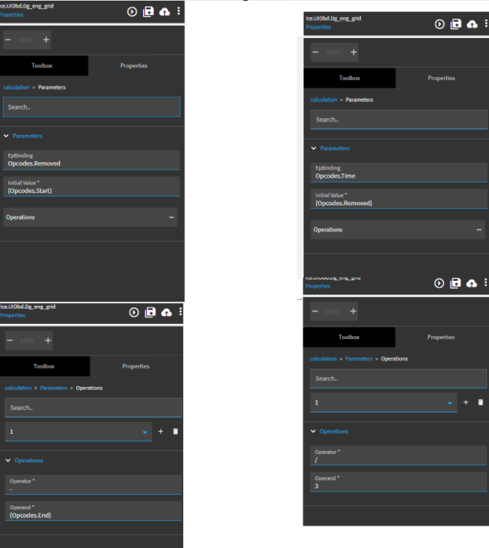

First is on the left, the problem one is on the right.
The condition on the final event is always true in the case I’m testing.
So basically its trying to subtract 2 numbers in the second event, and output the third into a new field. Then the next is trying to divide that resulting number.
I don’t know if it matters but these fields are all additional columns I added to a dataview. I tried them with UD fields that are EP bound, but the same issues happened.

What are all the data-commits doing? Why so many?
You might want to try doing all of your calculations in runtime variables (TransView) and then committing only once at the end.
