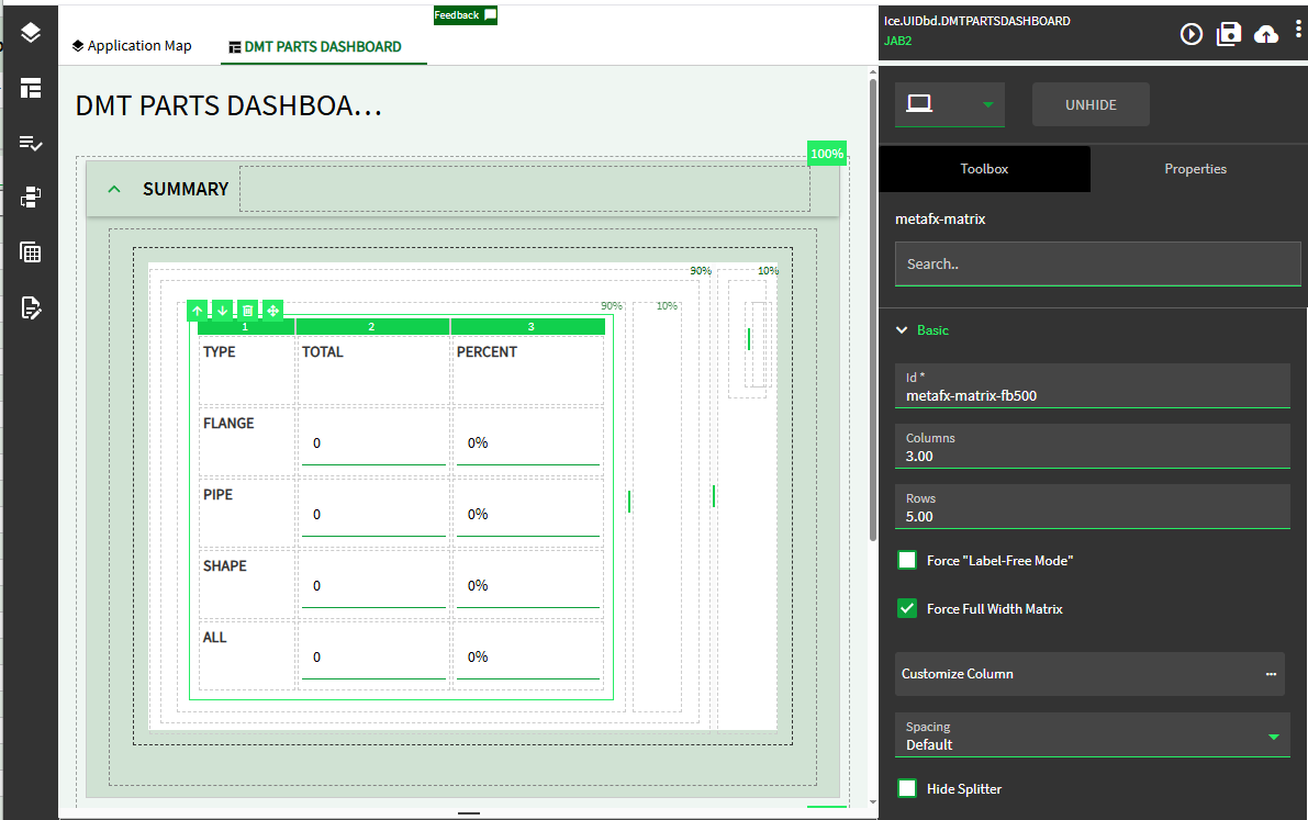

You can also use the matrix component to align controls. Like:
The what now?
I don’t think that’s in 2024.2…
tablix, matrix, idk what its called. its in there somewhere. :wink:
Umm… that’s SSRS
configurable cols & rows and each cell is a multi-component container.
I mean I believe you, but what’s the widget called in the toolbox?
Like Container and Group Box come across as metafx-box and metafx-flex-box or something utterly unrelated to the toolbox names.
I assume it’s new to 2025, though.
Yep, don’t have that.

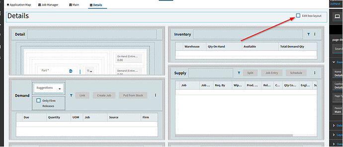

Another option is to click ‘edit box layout’ and get the various panels to snap to grids (instead of free-form columns). I haven’t tried this for fields within panel cards, though.

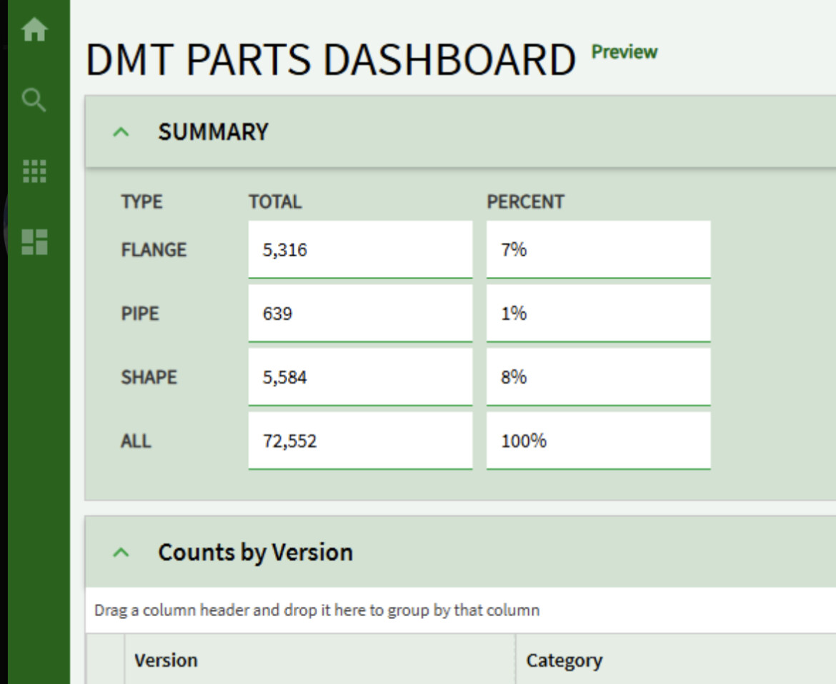

Thanks for posting this. Saw it in the what’s new video months ago and then couldn’t remember what it’s called so couldn’t find it the other day. Needless to say, bingling ‘grid layout’ didn’t help.
It’s new in 2025.1
