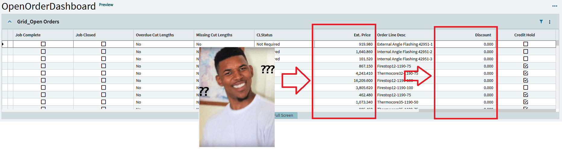

Jumbled columns
  • I’ve created a nice BAQ and spent time organising the columns in a neat readable format for the users.
  • Added the BAQ into a dashboard via the Application Studio Wizard.
  • It has then decided to scramble all of my columns.
How fantastic! :rage:
Is there any way I can stop this from happening?

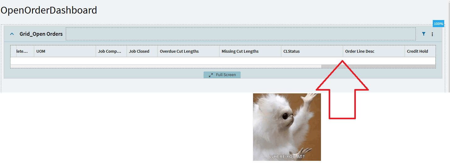

Missing columns
Noticed on the grid that several of my columns are missing.

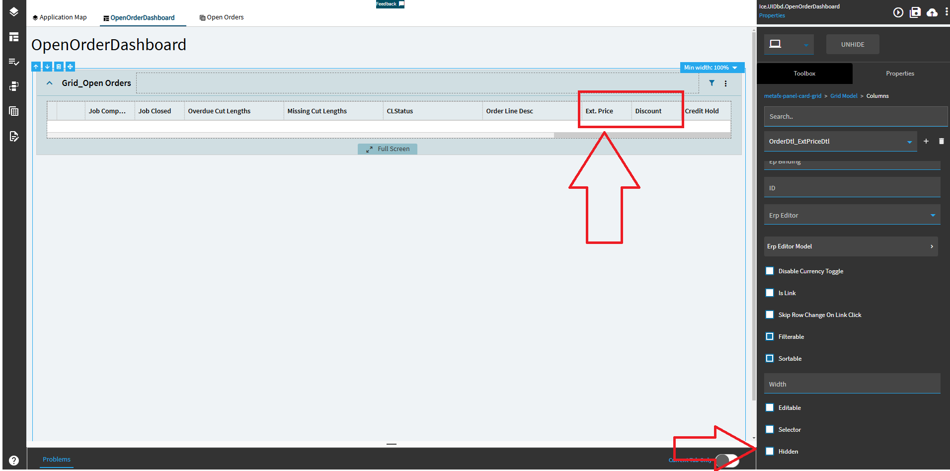

I go into grid, columns, find the offending column.
Then uncheck the “HIDDEN” box.
I now see the column:

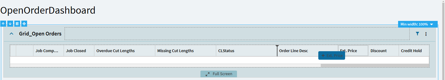

I try to move the column:
Column magically disappears:
I press preview and its there:
But I cannot move it or modify it in application studio! Why?! Am I doing something wrong here or is Application studio just a buggy mess?
Uncheck toggle currency on those fields. Its a known bug.
See this thread for some more background and the workaround that @aosemwengie1 mentioned.
Thanks so much everyone! That has fixed it.
