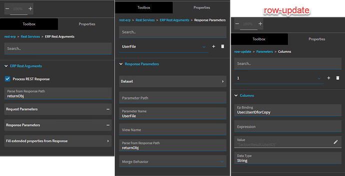

Show me how you set up your REST widget response parameters.
If configured properly, you should be able to use this in the value field of the row-update: "{actionResult.UserID}"
I hadn’t set this up, how would I go about this?
thank you.
Parse from Response Path should be returnObj and Parameter Name should be UserFile.
Do I need to specify actionResult anywhere? I’ve tried different things but actionResult is always undefined.
That used to just work. Looks like you need to specify it now.

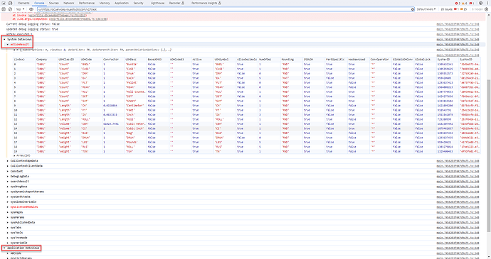

Should you expect to see actionResult in your devtools dataviews afters (ctrl-alt-v that is)? I don’t, but maybe it goes out of scope as soon as the event exits?

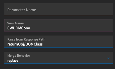

I created my own dataview to hold the data and that seems to be working in the meantime:

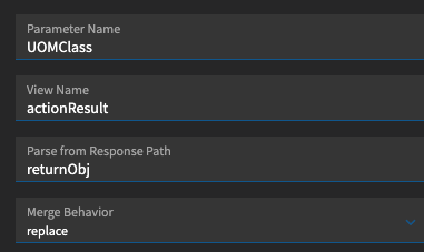

TYPOS BELOW IN SCREENSHOTS: Parameter Name should be UOMConv not UOMClass to get the conversion factors I’m after. Just noticed that.
I originally tried this but it didn’t seem to work, I thought I just needed the path to the data:
As far as creating the dataView to receive the data, I’m only interested in a couple of fields, ConvFactor and ConvOperator, so I tried adding just those in the data view page, but seems it populates all fields anyway. Nevermind.

This is all correct (minus your need for UOMConv instead of UOMClass). You just needed to look in the “System DataViews” to see the data in Dev Tools; it’s collapsed by default.
Parameter name needs to be the table you want data from (UOMConv).
Parse from Response Path will only be returnObj.
Aha! That’s where actionResult is lurking
