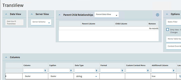

In the Kinetic form (2025.1.6), I have the TransView filter column defined:
It’s bound to a text box.

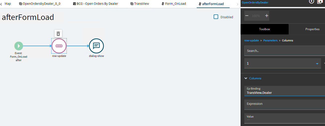

After form load, I am initializing the TransView filter field:

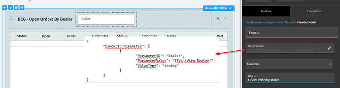

Under the Provider Model for the query, I have the parameters specified:

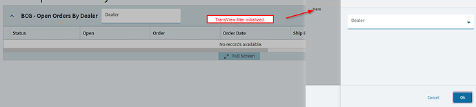

The issue is that I still get the slide-in panel requesting the parameter.
